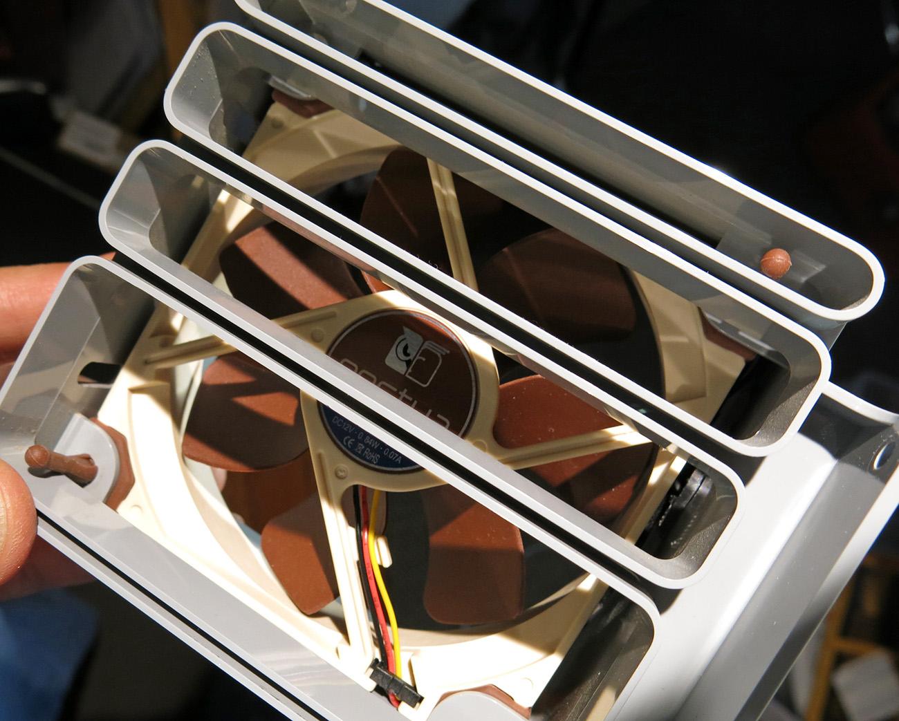

I’m rebuilding my 2010 Mac Pro 5,1 and replacing the stock fans with Noctua 3-pin ultra quiet models. What I’m having difficulty with is disassembling the pci fan cage.

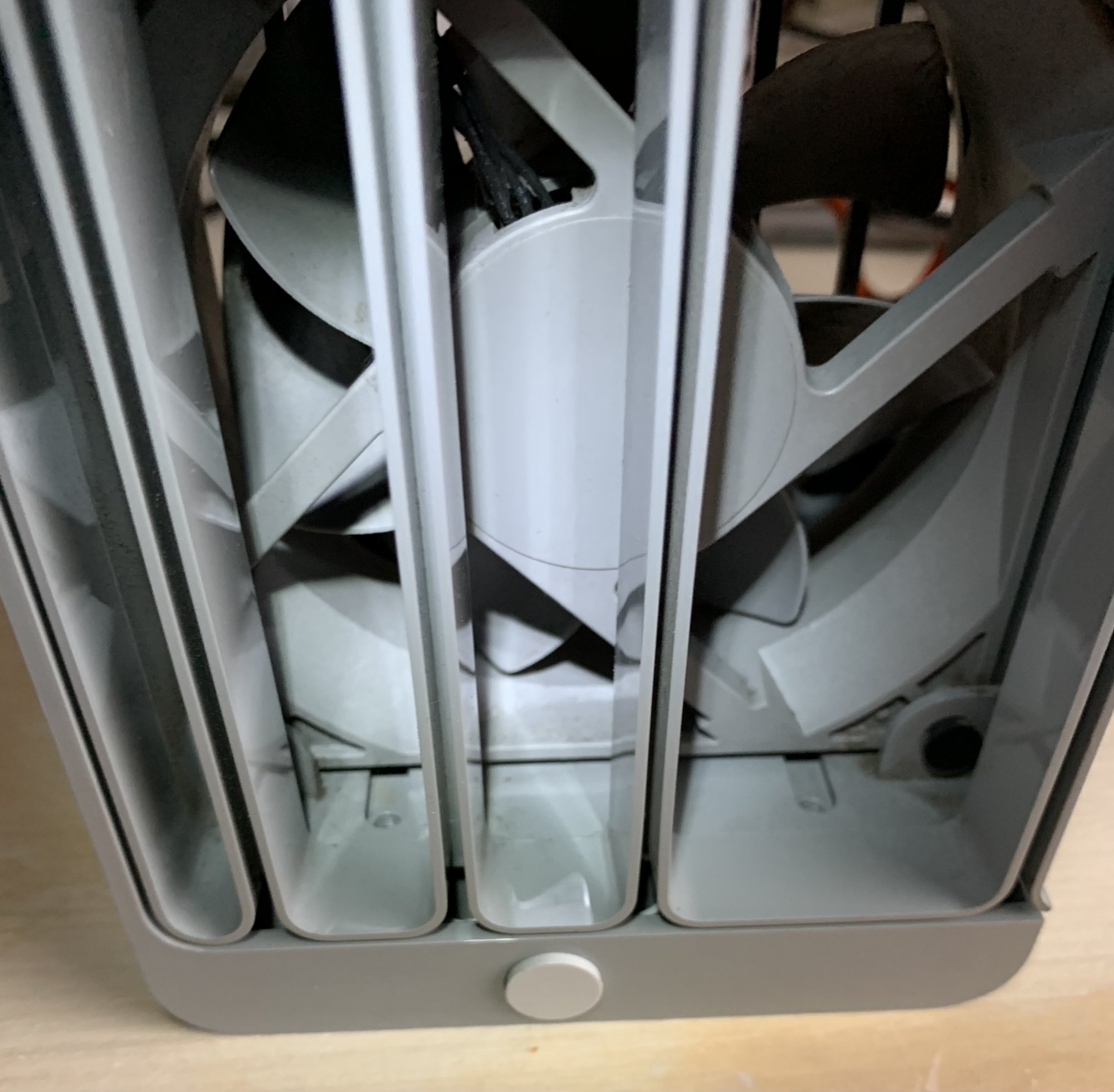

I’ve removed the two screws but I am unable to determine how it’s still being retained.
I looked at the clip holding the pin for the button and it looks like it’s part of the housing and not a separate piece.

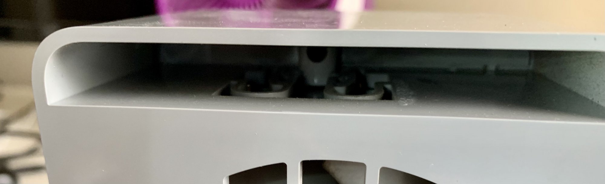

I've finally managed to do it 😉 Didn't find the 3mm hex screws at first, but then it was still stuck after unscrewing them... I slid a Jimmy between the button and the cage (where the PCIe slot numbers are) and it snapped loose fairly easily.
Reactions: KeesMacPro
There's a position at the end of the slot where the outer cage can be carefully forced to slide over the inner casing.
