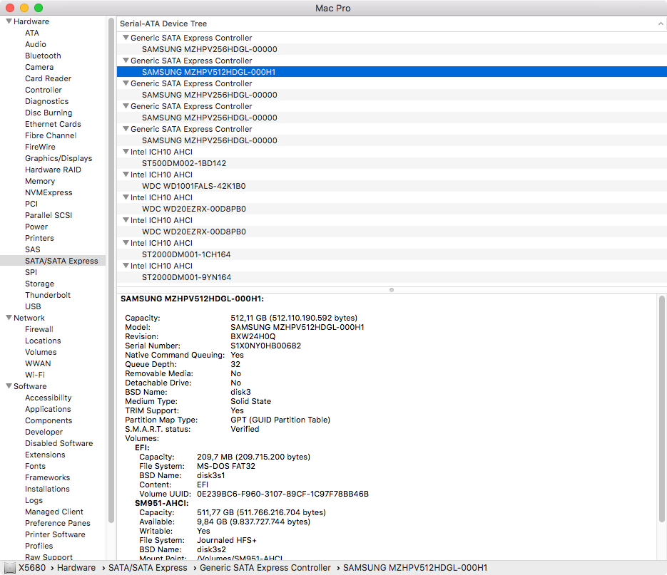

I know what I'm talking and you don't, I have a SSD7101-A with 4 SM951-AHCI and another one alone, why do you post about things that you don't know?
