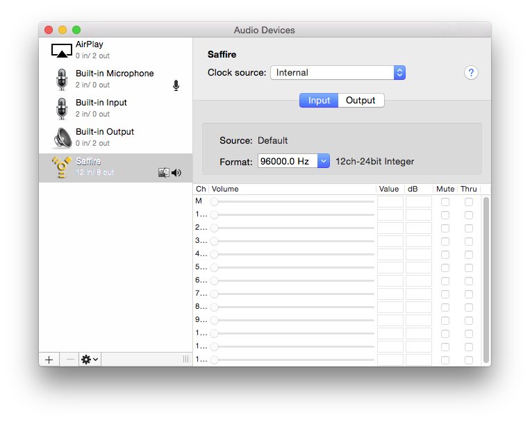

You can use it to test whether you're sending the sound correctly.
You'll see your receiver listed on the left hand pane. I am on an external firewire interface so that's what I'm seeing.
Select that, the go to the output pane.

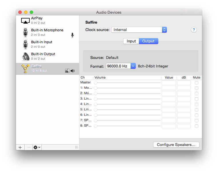

Once that's done, click configure speakers at the bottom right.
From there, select multi-channel and a 5.1 speaker configuration.
Once that's done, click each speaker, a test tone will play through that speaker if everything is working as intended.
