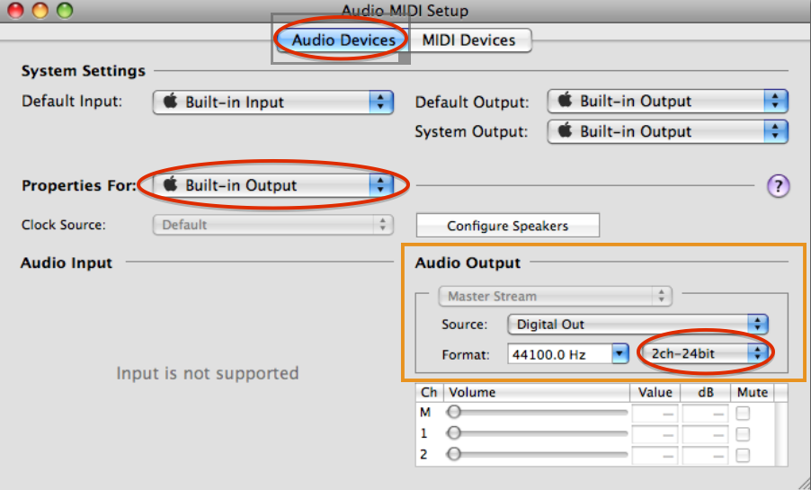

Tis a bit of a bug with VLC. MPlayer does it too sometimes after exiting.
Just go to applications / utilities / Audio MIDI Setup
Prperties For: Built-In Output
Default Output: Built-In Output
System Output: Built-In Output
Under Audio Output: Source - Digital Out - Format 44100.0Hz - change 2nd drop box from from "Encoded Digital Audio" over to 2ch-16bit or what have you.
Make a shortcut to audio midi setup on your dock, so if you happen to watch a lot of 5.1 videos - you can fix things in a jif.
FYI, the system audio will be hijacked until you close the media player (under normal conditions) so if the movie stopped, and you leave VLC running, you have no system sounds until you exit VLC.
Sucks at first, but I got used to it.
What you "should" see after closing VLC / Mplayer.
Hi,
Thanks for the response. I changed the audio back from 24-bit to 16-bit, however the sounds are still gone.
Did you quit VLC - or just "X" it out?
If VLC crashed - you might have to force-quit VLC before it changes.
That usually does the trick for me.
What decoder / receiver are you using? Maybe that is hung up? Try toggling inputs on the receiver / decoder - see if that wakes anything up. Ones in a great while, my Z-5500s need a quick input toggle to get it listening again.
