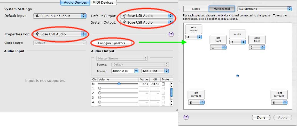

As finnschi mentioned above the Audio MIDI Setup program in your Utilities folder would normally be used to define such things as the audio output setup (after of course you have set up the Output info in the Sound pane of System Preferences first).
Just to make sure you are seeing something similar I have attached a pic of that pane and the resulting speaker configuration window. Now I am assuming that for the output device and system output you will need to select the sound card (everywhere mine says "Bose USB Audio" that is) and you will need to make sure that is selected before you click "Configure Speakers".
Is the second pic (the result of clicking "Configure Speakers") similar to what has come up in your Audio MIDI Setup? If not then I am lost to be honest, but I wanted to show you what one that works looks like in the setup process anyways in hopes that it might help you see something that might be getting missed or such! Good luck with your setup!

I think I know the problem, but can't figure out a solution... In the midi audio when I select configure speakers like on the picture, if I select multichannel the only thing in the drop down menu is stereo. It won't let me select 5.1 surround sound.
Is there something Im not doing with my usb soundcard right or is it another problem?

Thankyou for your posts guys!
