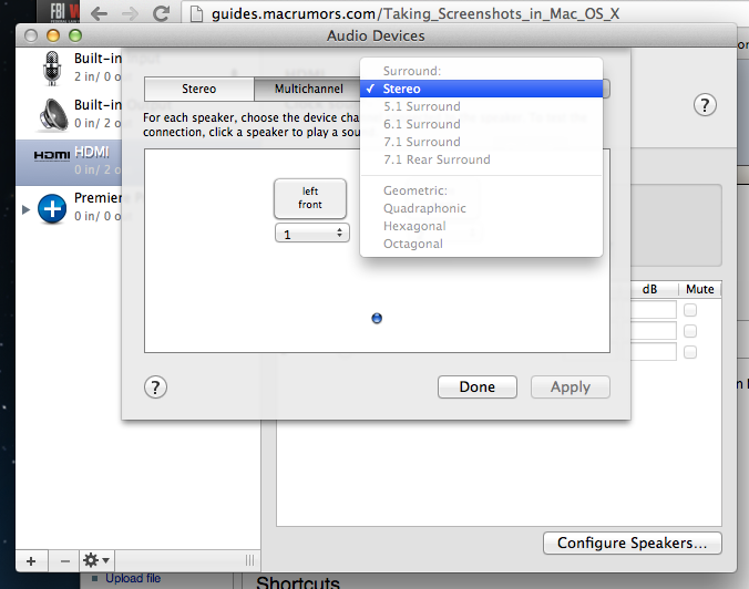

I have been searching for about an hour to try and figure out why my 2012 mac mini will not send 5.1 over HDMI. I have attached 2 screen shots of the Ausio MIDI setup but most boxes are grey out. My Mac Mini is connect to the TV and then TOS cable to the AVR. I have tested and I know my Roku sends 5.1 no problem the same connected way. Anyone got any ideas?

I also have the same problem wherein the multi-channel is greyed out. I am thinking maybe the sound card in Macs only have stereo capability natively. I then added a Marantz 7.2 multi-channel receiver to my Mac and used Pro-Logic from the Marantz to give that 5.1 effect.
Connect the Mini directly to the receiver via HDMI and connect the receiver to the TV via HDMI. That should work.
I have tried going straight to the receiver than to the TV with no luck either. I have also tried different HDMI cords to rule out that possibility. Would going for optical out be any easier?

I have a 5.1 speaker test video I run and it confirms that only stereo is coming down the pipeline. Audio/MIDI settings show the same greyed out options in the original post in this thread for anything but stereo.

You have to plug the Mac's HDMI output into a surround sound capable device (like your AV receiver with HDMI input).
Most (if not all) TVs are stereo and so will accept only 2ch from HDMI. ARC only transmits stereo audio because of copyright issues. Check your TV's manual, it will mention this in the description of ARC.

Yeah I plugged it into my receiver and Audio/MIDI Settings recognized the device as having 6 channels.
It's a little less convenient than passthru but at least I'm getting 5.1 now.

I turned of ARC and it seems to resolve the problem. Receiver is now receiving multichannel from my mac mini instead of 2.0. The down side, turning of the TV and AV receiver separately.

Apple MIDI won't recognize more than 2 channels when plugged directly into a TV or via USB to TOSLINK (Optical Audio). No Apple apps will.

From my research, appears as though the only way to get Apple apps (like MIDI) to recognize the distinct speaker channels is to connect HDMI directly to an Audio Receiver. (And this is only for recent Macs; appears as though TOSLINK (optical audio) was better supported in the past.)
