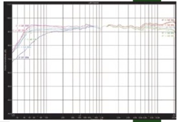

Well, at the moment, I can't find any response graphs anywhere, but I have seen some. If I can't get hold of any, I'll just take a picture of the response graphs on my Samson monitors or my DM7s (both of which have response polygons available).
Instead, I've uploaded a shot from a review in Electronic musician of the KRK ST8 monitor (mid price range monitors).
attachment.php
You can see how KRK have even highlighted the part which says the hi-end smooth. Any audiophile would be able to tell you that a speaker which has flat response would be impossible to listen to over a long period of time, the high end would be incredibly fatiguing over time...

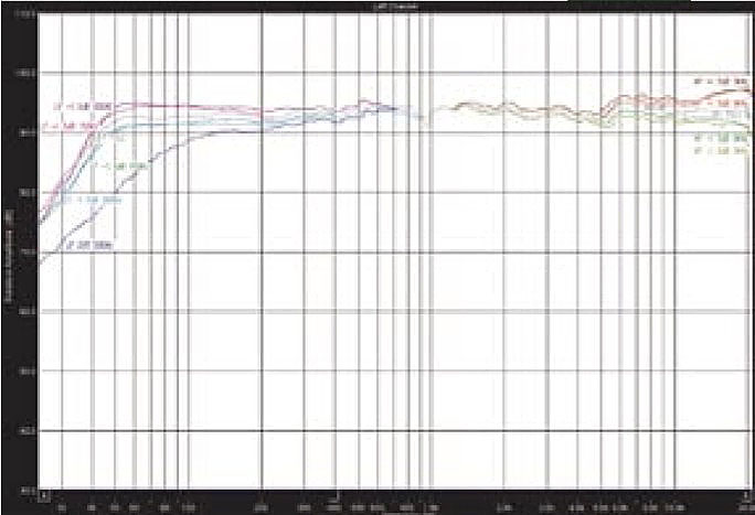

Here's a response graph from the VLX5's can you tell me if it looks good or not? I'm not going to be able to demo these speakers.
I thought that 'flat is good'?
here's where we're talking past each other: smooth is a subjective term, whereas flat has a pretty well-defined meaning.
i'm well aware that the freq graphs are going to show a high-freq rolloff at some point, because of the physical limits of design. it's where that point is that will further the discussion. if it's around 20k -- well, i can't hear that high, so it doesn't matter. if the rolloff is around, say, 16k, where i can still hear some, then i'll start to wonder if that was a choice.
i do not, however, interpret "smooth" to mean "non-flat".
Nah, they are so annoying, it's in a vector pdf but they must have stuck a jpg in, I know it's bad but I was hoping you'd sort of recognise where the particular frequencies would be marked...is that a bit too much to expect?
Maybe this is better, it's the same res but I've blown it up and sharpened it.

I'm not saying flat is bad, it's just it's really difficult to listen to for more than ten minutes or so.
That response curve looks fairly flat, but if anything there's a bit too much hi end.

zimv20 said:
yeah, kind of. i will say that that curve doesn't look particularly promising.

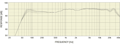

OK I've found someone not too far away who had the ALP5's and some other stuff like the Rokits, but they also have a demo pair of Yamaha MSP5A's that they have offered at a pretty good price.
Any opinion on the Yammy's? They are usually a fair bit dearer in the states than all the other 5 inchers, even though they only have a 40W woofer.
Here's a freq graph, would they be better speakers than the VLX5's or rokit RP5's, as I might be able to get them at the same price.
