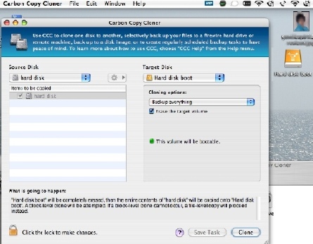

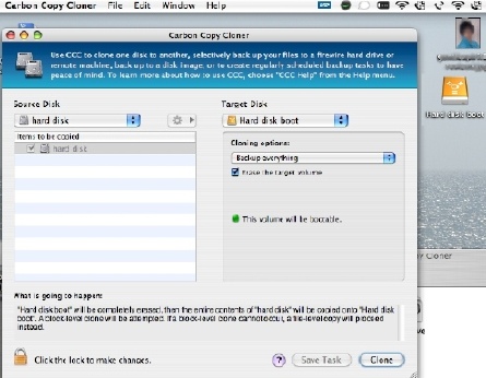

OK, I cloned it again and it did say it would be bootable! But, as before, it doesn't show up holding down the option key, the icons do show up on my desktop and I did click to erase it before it cloned 🙁 and fire vault was off?http://images.macrumors.com/vb/images/smilies/confused.gif
I know not what to do!! Was I supposed to do something to to the external hard drive before using it??
Thanks again!!!
See attached picture!
Any Ideas??

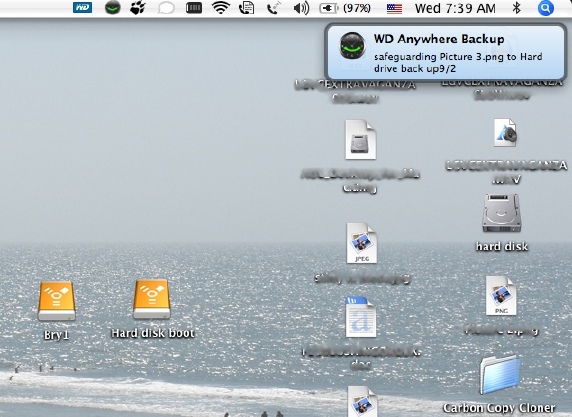

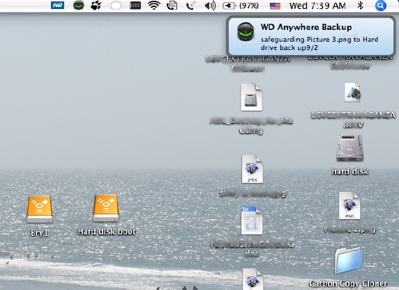

I have never been able to boot up from it althought the icons do show on my screen and I can click on them and get to the files and infformation. I have it partitioned into 2 sections,( hard sidk boot) & ( Bry1) both icons appear on the desk top.
I cloned my hard drive aggain yesterday, took hours, named it" hard disk boot9/2" can't find it ????
The format of the external drive is whatever it was when I bought it( brand new) it said it was formatted for both MAC & PC.
Thanks,
Bryan
