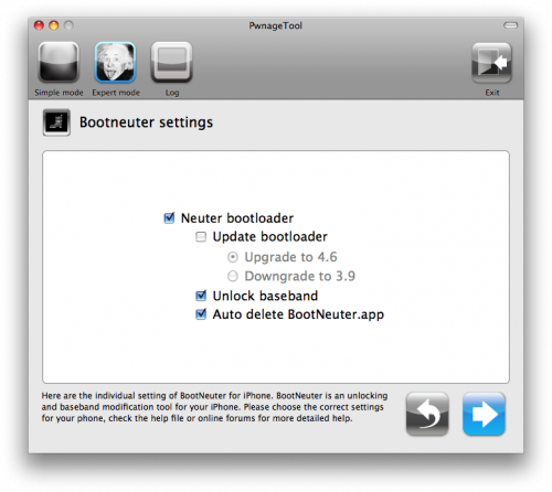

So in step 3, you're using these settings for Bootneuter, yes?

If none of that is the case, you might try changing the bootneuter options so that you have bootneuter replace the BL on your iPhone (that is, check update bootloader in the screen above and select the appropriate option, which one I guess doesn't really matter).
