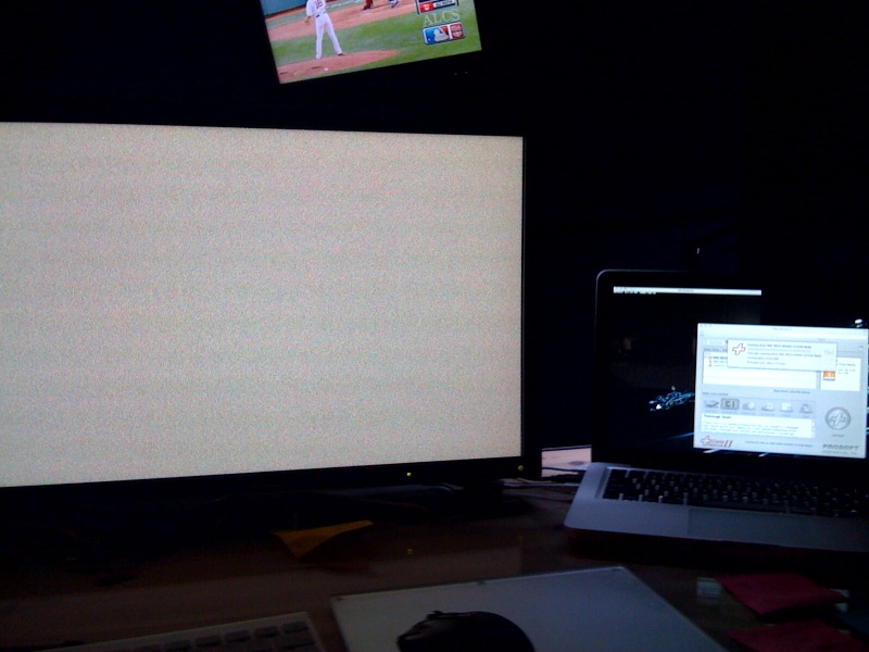

I picked up a new MacBook yesterday and I noticed a weird issue when coming out of "monitor sleep" mode, not regular sleep mode.
When I move the mouse, the external monitor shows what you see in the picture, kinda like a TV with no signal. The MacBook screen works fine so what I just do is unplug and re-plug in the DVI plug and everything is good again.
My 24 inch Dell monitor worked fine with my M1330 and other computers so I know it's not that. Does anyone have the same issue or maybe give me some light on this?

Same here. Just plugged my new MacBook into my ACD24" this morning. Was working fine, although not as crisp as my old MBPro drove it. Went may a tea and cam back to find the screen asleep. Move mouse and the ACD went nuts and flickered then dropped out to the coloured fuzz shown above. :( Hope this is not a hardware fault or it's going back!

It's a pretty common problem with the new Macbooks on various external monitors, including Apple Cinema Displays. The only workarounds I've found with my Dell 2407 was to either:
1) CTRL+SHIFT+EJECT to sleep the monitor and then any key to resume
2) replug the mini displayport adapter
3) prevent "display sleep" if using bootcamp Windows and just use "sleep"
