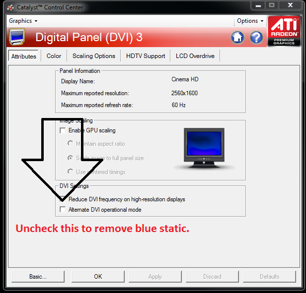

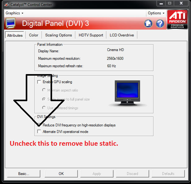

Mostly FOUND IT!
This almost always makes the blue lines go away on Windows. (The enable alternate DVI thing.) It's checked by default. I'm still in Windows now. If only I knew what that box did and if only it appeared in OS X.
There is still some noise after a while though. The Reduce Timings box takes care of almost all of the rest. After some use, I'm still getting static but it's like one flicker every 30 seconds or so instead of a constant barrage. On the right track though!
