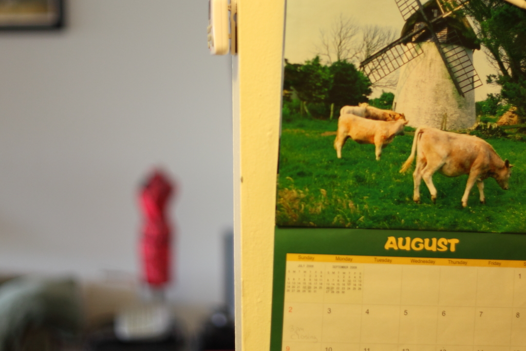

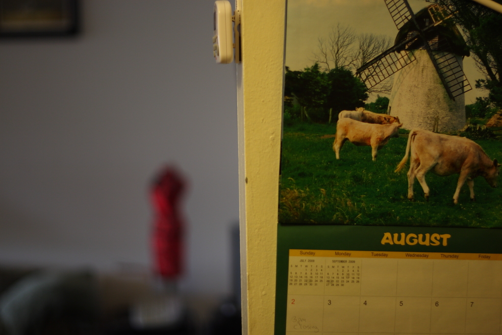

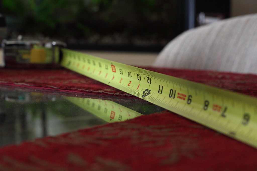

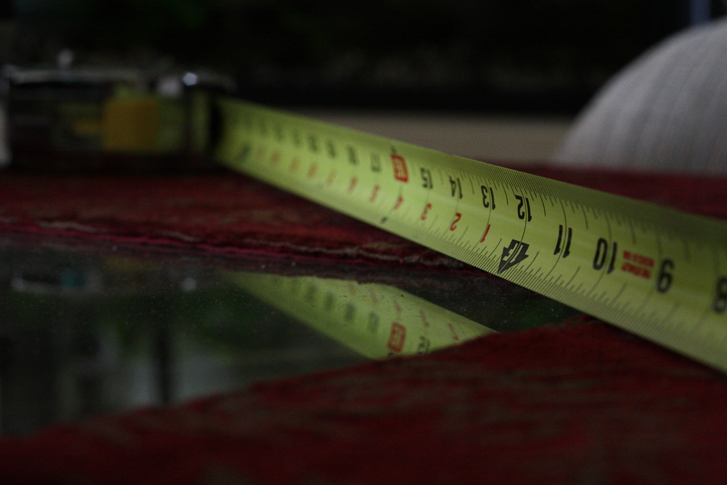

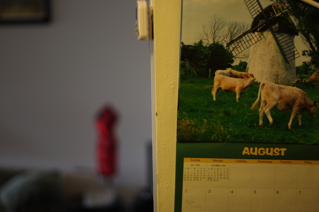

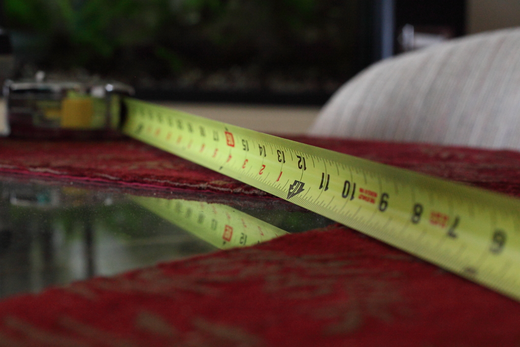

bright shots: 5dmkii, darks shots: 30d
both taken with the same 50mm at F8 at the same distance focusing on the same point
If you read the link macjonny1 posted, this should make more sense now, if you haven't. go read it and understand why you can't see the differrence in DOF between either camera (1.6x vs FF)
Now realize that i had to crop the 5D shots to match the 30D shots because the FF camera has a wider field of view, but the circles of confusion are still the same. Now, had i zoomed in on the 5d to match the field of view on the 30d, the circles of confusion would expand and created a more blurred bokeh.
circles of confusion relate to but are different than DOF, DOF is how much is in focus, while the circles of confusion tell you just how blurry the out of focus parts are.
any questions?
any questions?
why is one darker than the other?
the DOF looks identical to me btwn the dark and lighter ones.
maybe if you actually point it out w/ markers on the images, it would help more.
sorry,
it's painfully obvious you are ignoring the technical points i made and didn't at all read the other link posted which explains things clearly. So until you actually read that information and we can have an informed conversation, i really can waste my braincells on something more interesting... like clipping my toenails.
oh and they are different brightnesses because the sensors have different sensitivities and i used different ISOs, but that's a whole nother' discussion i don't think you would fare well in.
toodles,

sorry,
toodles,
i read that article but it is painful as anyone can attest. and if they say they enjoyed reading it then they r lying. all i can say is that i tried reading it. now, r u happy? and then here u r, with your visual examples just pointing out my doubts how little, if at all, sensor would affect DOF in real world practical terms.
but there's more, you purposely made one brighter than the other to make an arbitrary point about one sensor being more sensitive than the other. i don't even wanna begin to go there. a better attempt could have been made (if what you say about sensor-sensitivity is true) to make the exposures more EVEN. even, if it means the setting being different because exposure has nothing to do with DOF. unless, i am wrong there, too.
