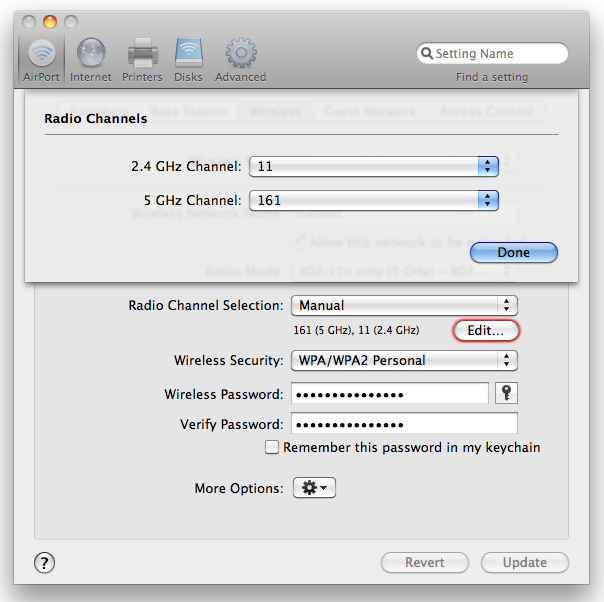

Try changing your channels.

Thanks for the responses. I've actually tried all the available channels but none have improved the speed.
