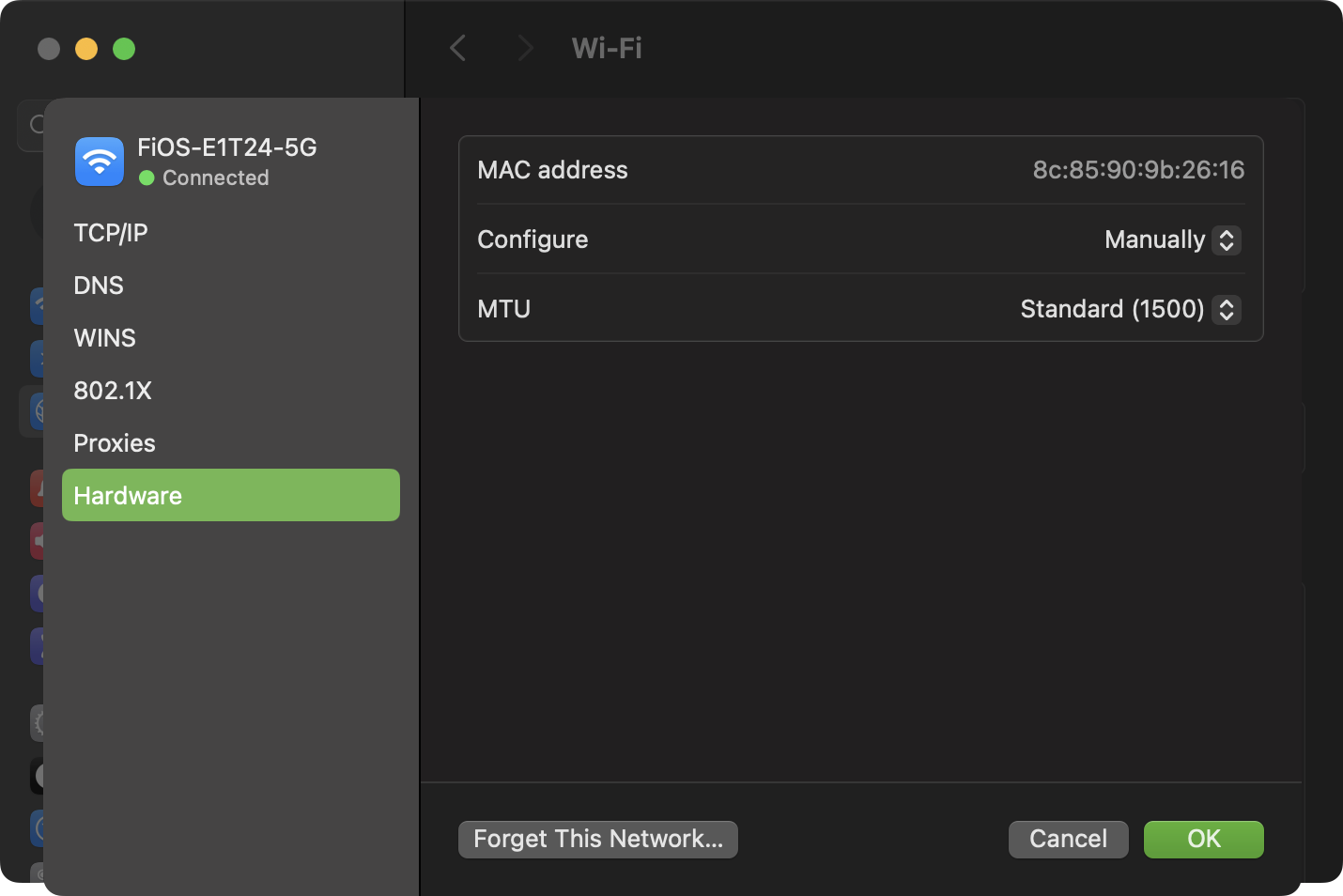

Yes I've restarted the router a couple times as well. I no longer have a pre-Sonoma backup, but I have deleted wi-fi settings on the mini and added them again. Just a minute ago I was able to connect via 5GHz and had a full strength signal, but Safari still said I was off-line. Now I cannot even connect again.

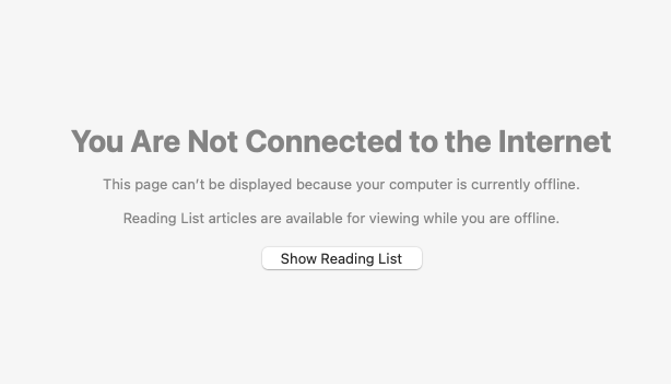

Well that lasted about half an hour. I can connect to 5Ghz now, but WhatsApp immediately says I am offline and running a speed test shows speeds of around 1mbps. It's possible a new neighbour has started doing something that is interfering with the connection and while I can use 2.4Ghz it's generally around 25mbps slower than I always had with 5Ghz previously. It's strange though when I can have an iPhone right next to it with no problems at all.

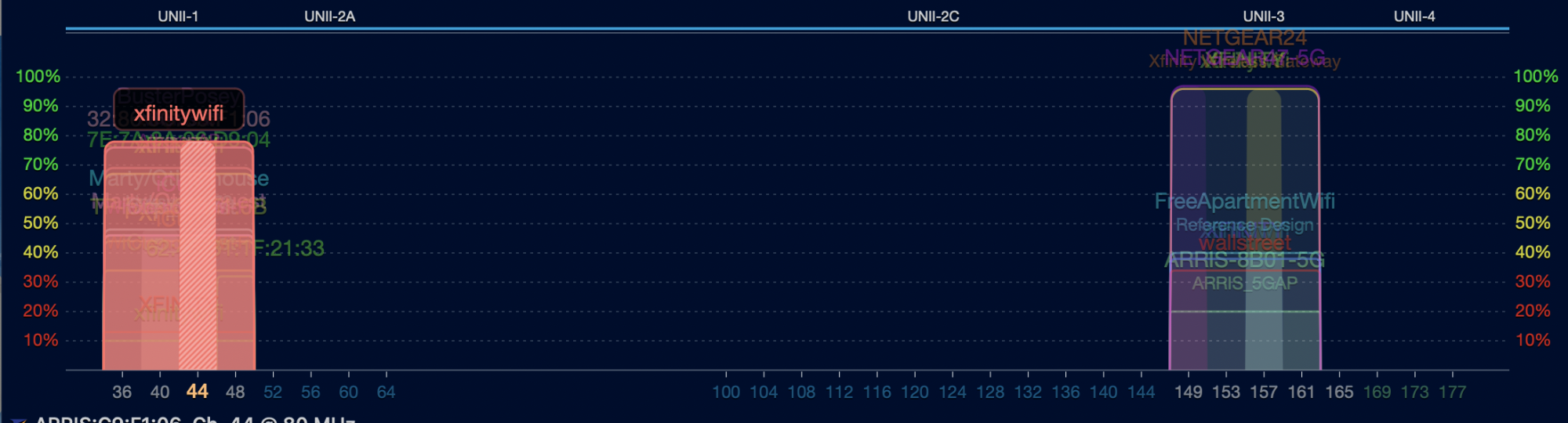

1. Check how many other 5 GHz networks there are with a program such as WiFi Explorer.
2. If there is congestion on the channel you are using try changing your router to a different channel
