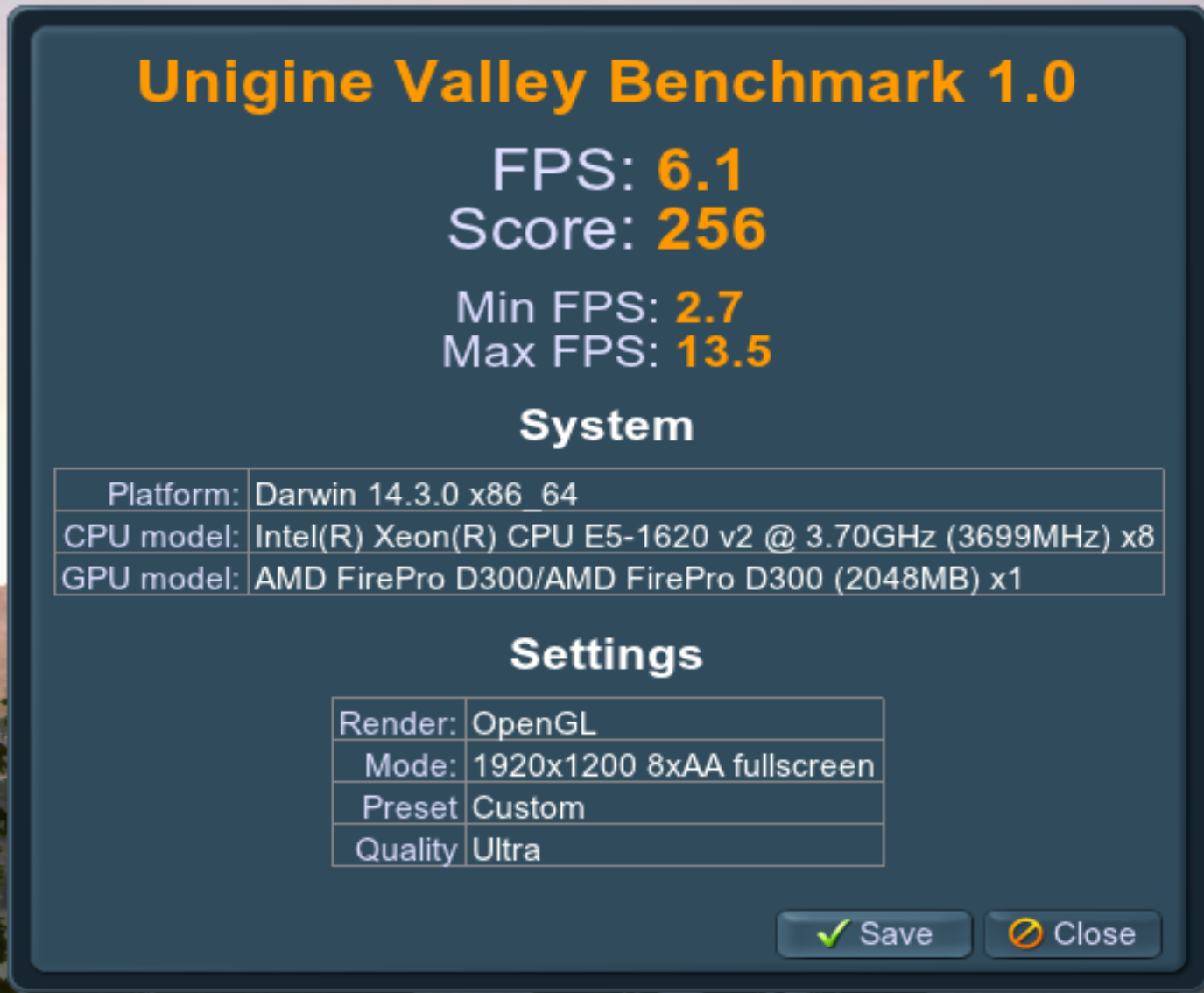

5K on nMP confirmed
And it boots right in, no need to cycle power. Sound is piped to the Dell as well.
Can't get it to run "Valley" at 5K though.
That's exciting and surprising. Which 2 TB ports are you plugged into? Are you spanning 2 TB busses or are both TB cables plugged into a single TB bus? If plugged into a single bus, I wonder if a second 5K monitor could be plugged into the other bus for dual 5K.
