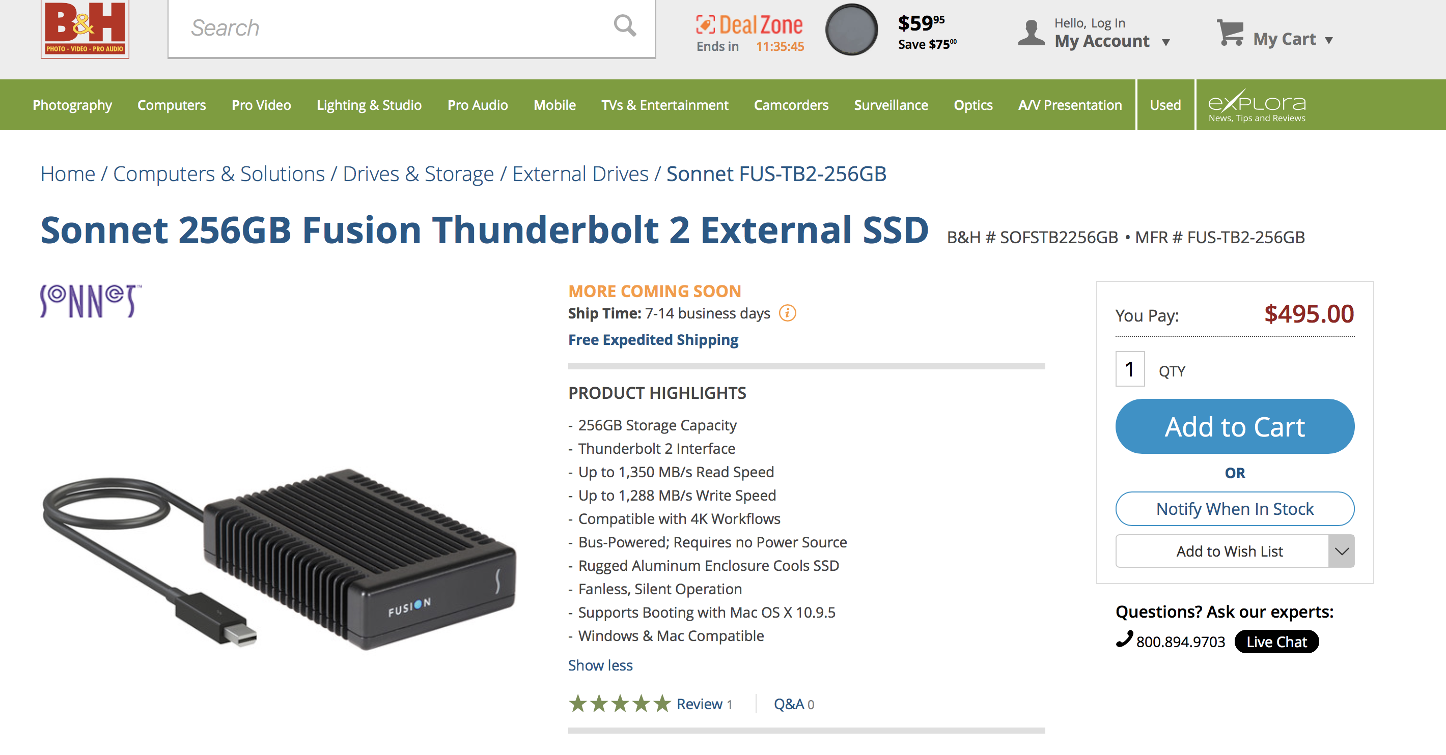

This is not the storage size you are looking at but I am impressed with the speeds, and it bootable. They also have a 500GB for $700 that is thunderbolt 3, so for my current machine I would need an adapter TB3-TB2. Hopefully prices keep dropping for this type of unit.
