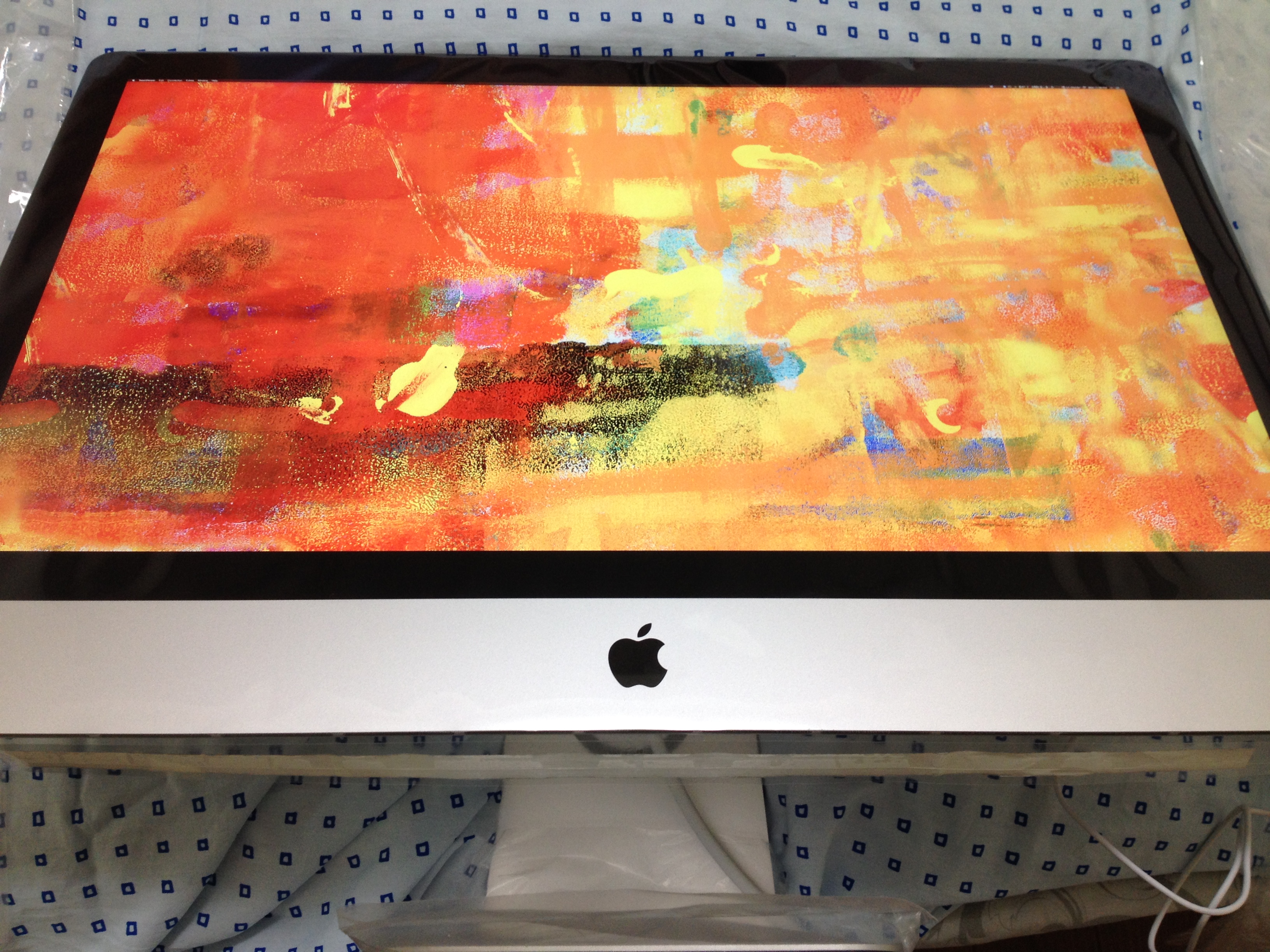

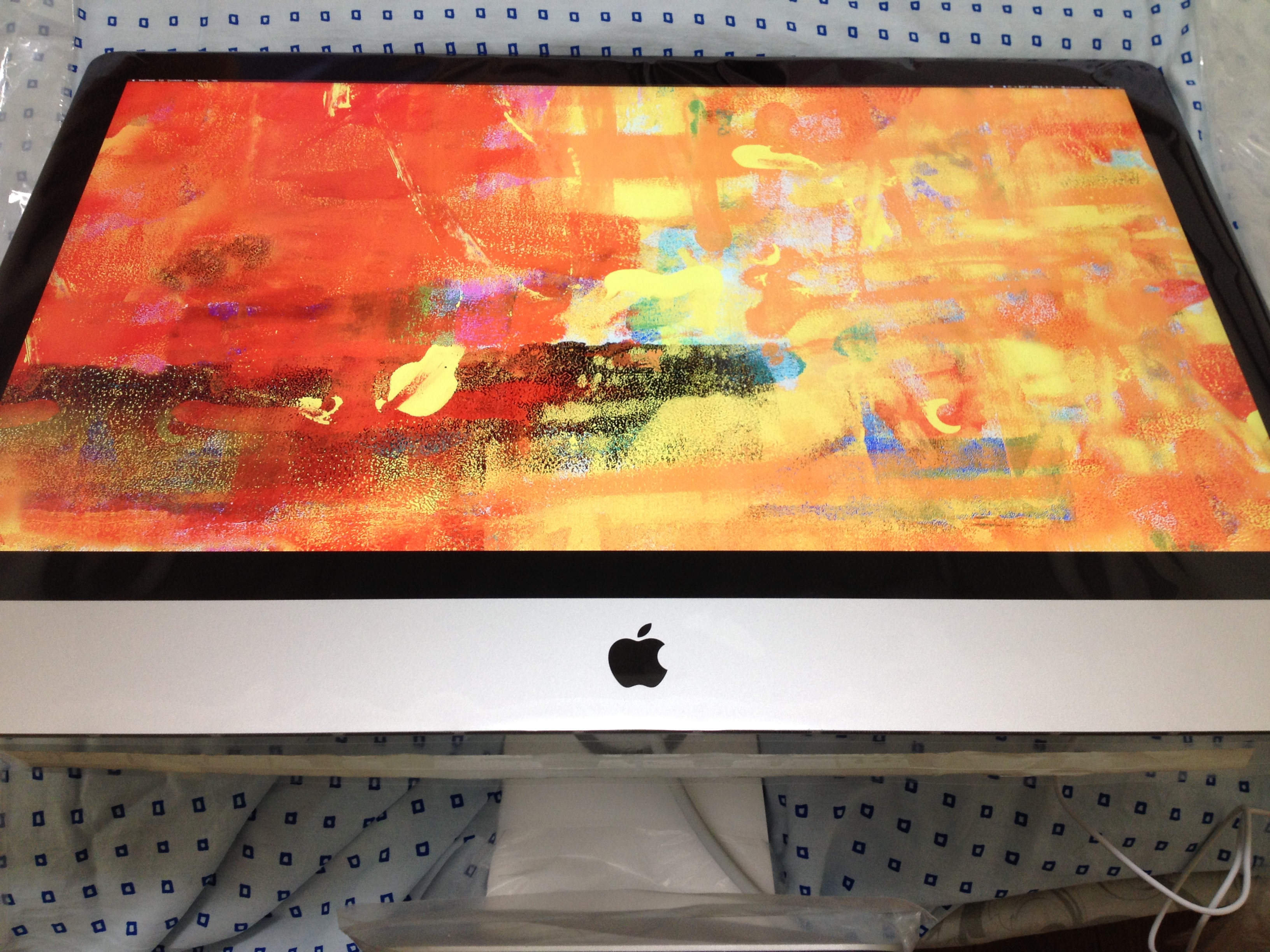

I just found the iMac's purring fan noise gone,
when I lay it down. 😱
