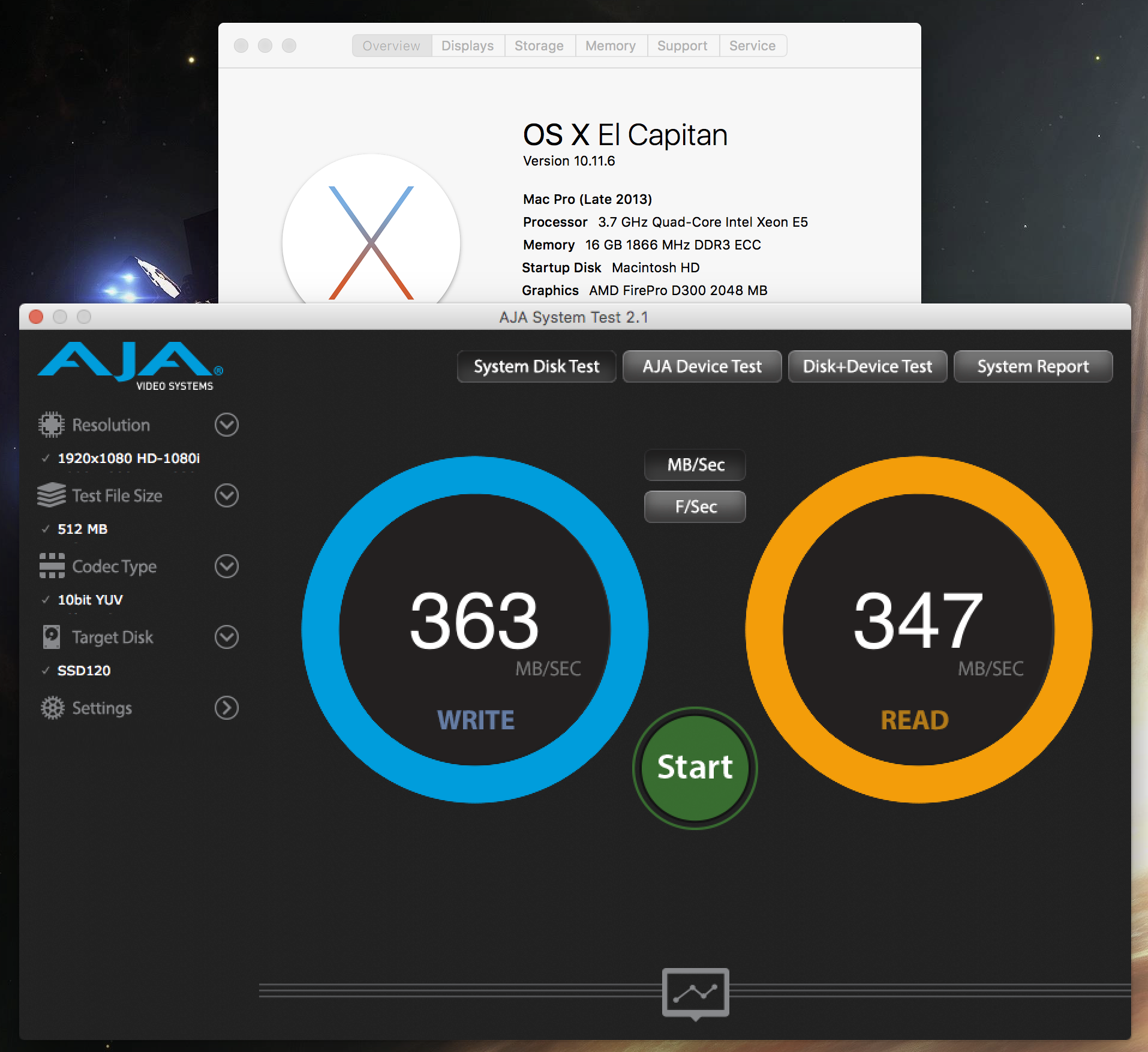

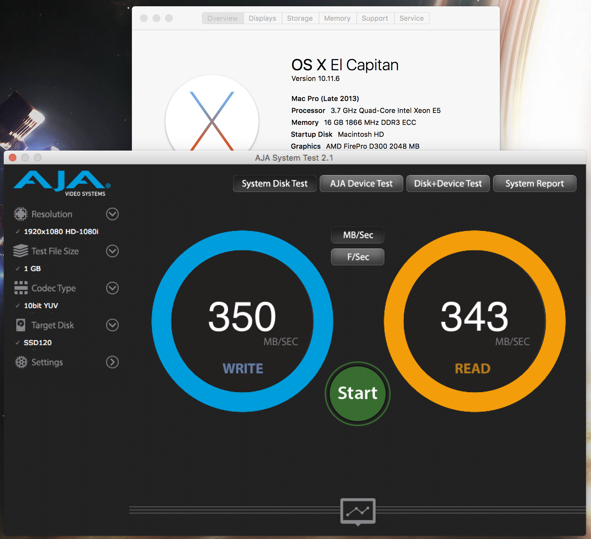

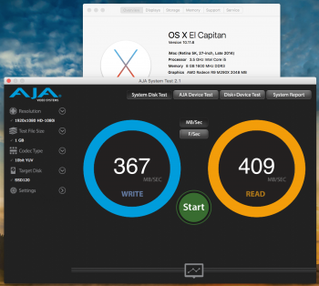

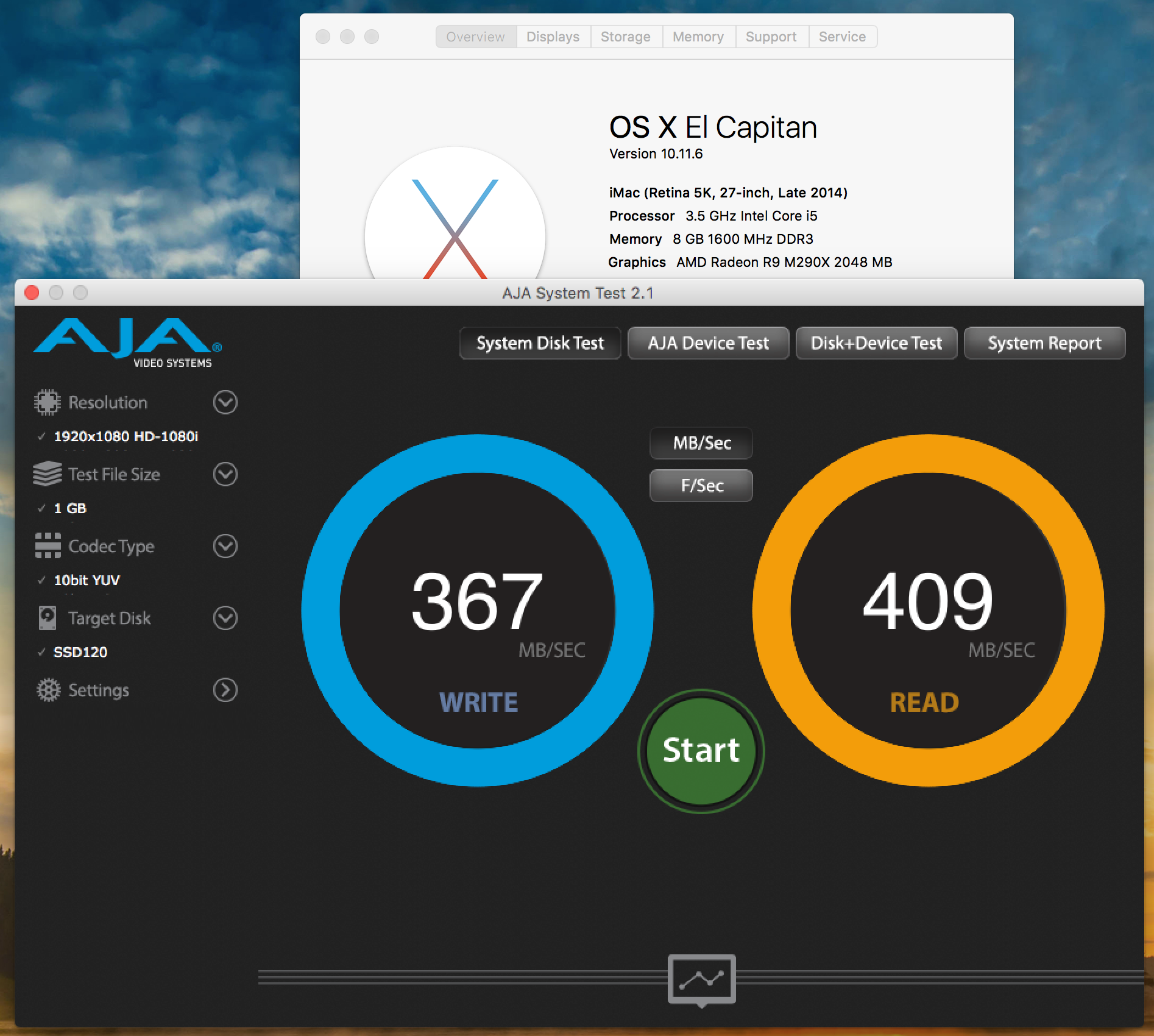

i have test my mac pro 2013 & imac 5K usb3 external disk performance using same drive (Transcend Storjet 25s3+intel 530 ssd peak (500/550mb)), and i found that mac pro is somewhat slower than iMac as shown in attached image.
is it normal?

Checked the test file size, noticed:
nMP - 512 MB
iMac - 1 GB
I would suggest to run the test again with the same file size.

just change file size to 1GB, nothing change.
