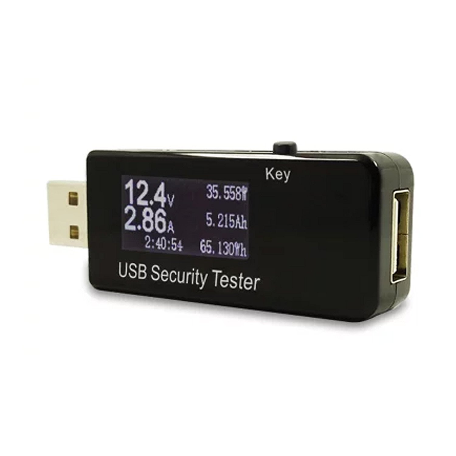

I treated myself to a nifty USB voltage tester (pic below from Amazon):
https://www.amazon.co.uk/Muker-J7-MultiMeter-Compatible-QC2-0-QC3-0/dp/B01DIPF350/
I tested it with a healthy iPhone, and it shows about 0.8amp, about 5w while charging. With the 5S, it's only showing 0.2amp, 1.2w, so it seems the battery is dead or there's some other problem with the charging system.
Now what?
