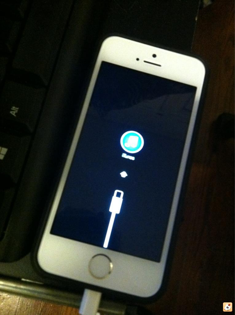

So then I remember recovery mode! So I do the hard reset for the umpteenth time and hold the home button and plug it back in.
Success! It enters recovery mode and shows the linked to iTunes screen (pictured). A message pops on the computer saying the phone is in recovery mode and to restore it to use it!
Won't let me recover to my recovery spot though. Wants me to RESTORE it and first it is making me download the current version of iOS to iTunes.
So I'm currently waiting *checks* 32 more minutes for iTunes to download 7.0.2 so I can attempt a restore and then I can recover my backup from iCloud.

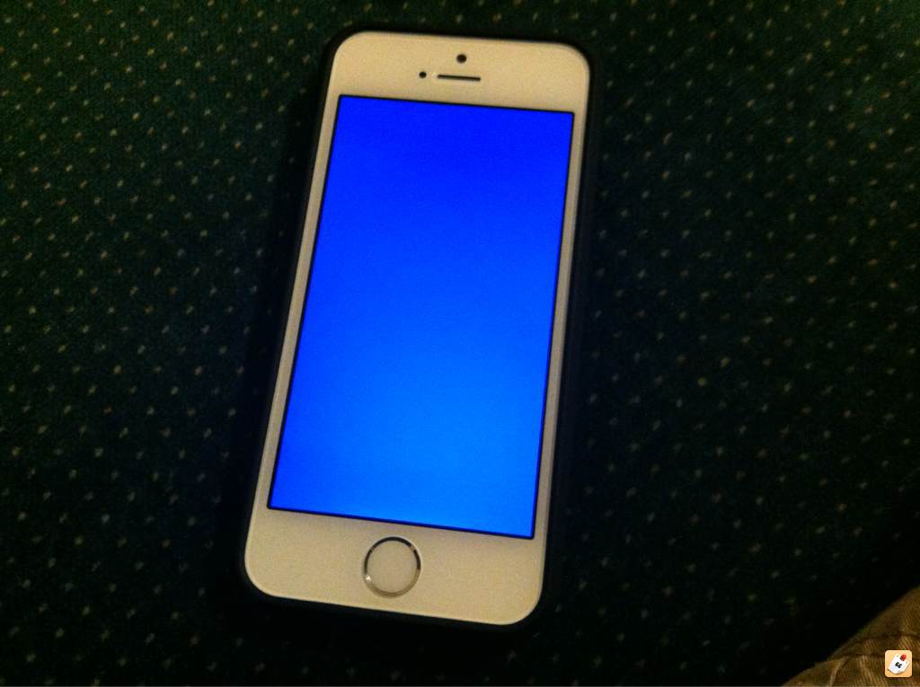

13 minutes till download complete. Phone dropped out of recovery mode and back into the loop after a few minutes. So I'm going to wait till the download is complete and then link it back in recovery mode for restore. Caught a pic of the blue screen. Sometimes it has red splotches or is half blue and half black.
Check out this thread https://forums.macrumors.com/threads/1641666/
I don't know if this would help you in your situation, but what you described sounds similar to what a few others are experiencing.
Ah so others have glimpsed the blue screen. Looks like I'm the only one getting the stuck rebooting loop though.
