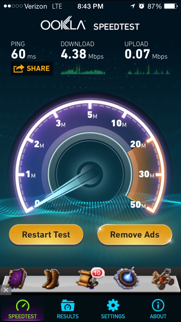

Can anyone else confirm the above regarding a special SIM and all LTE channels?
Asking cuz I noticed my LTE speed on verizon has been the *****z ever since I got my iPhone 6 plus.
My iPhone 5 has faster LTE speed than my new iPhone 6 plus.
Not only that, I am in the special XLTE area, and that should be blazing fast, but I am getting 4.xx mb down and 0.07 up.

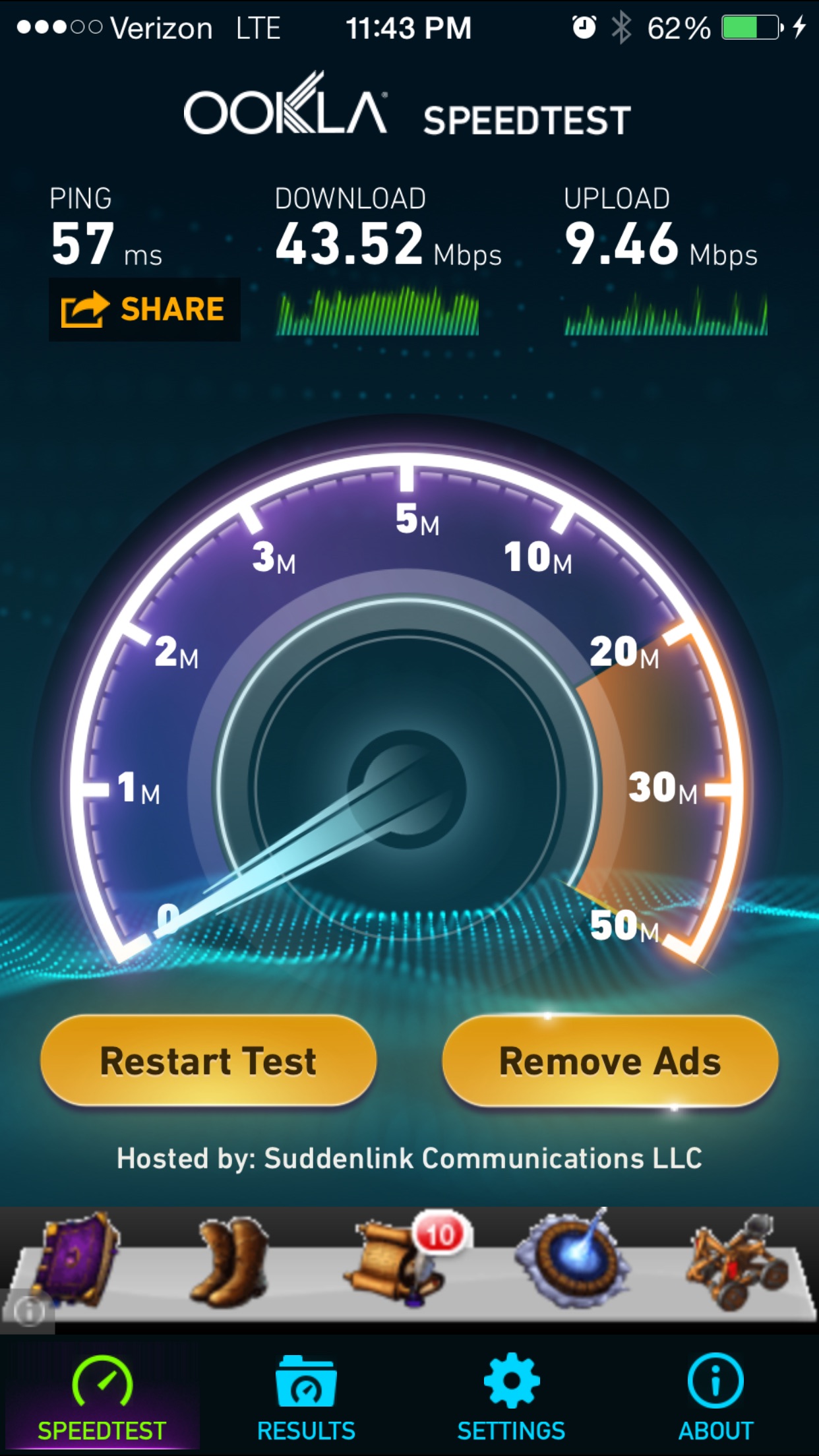

I put my 5S sim in my 6 plus and my phone works just fine. Still getting decent speeds

Guy here says you need to update to a series 27 or 28 SIM. I'm pretty sure this is what the guy who setup my phone at the Apple store told me as well.
http://www.howardforums.com/showthread.php/1847750-Anyone-experiencing-slow-LTE-speed-since-upgraded-to-iPhone-6-plus
I just spoke with Customer Support on this issue. Turns out I have a "25" series sim and the new LTE and iPhone Pay system requires an update to either a 27 or 28 series sim card. Additionally, I was told the IMEI provisioning on the account needs to be done manually once the new sim is installed. It does not happen over the air.
