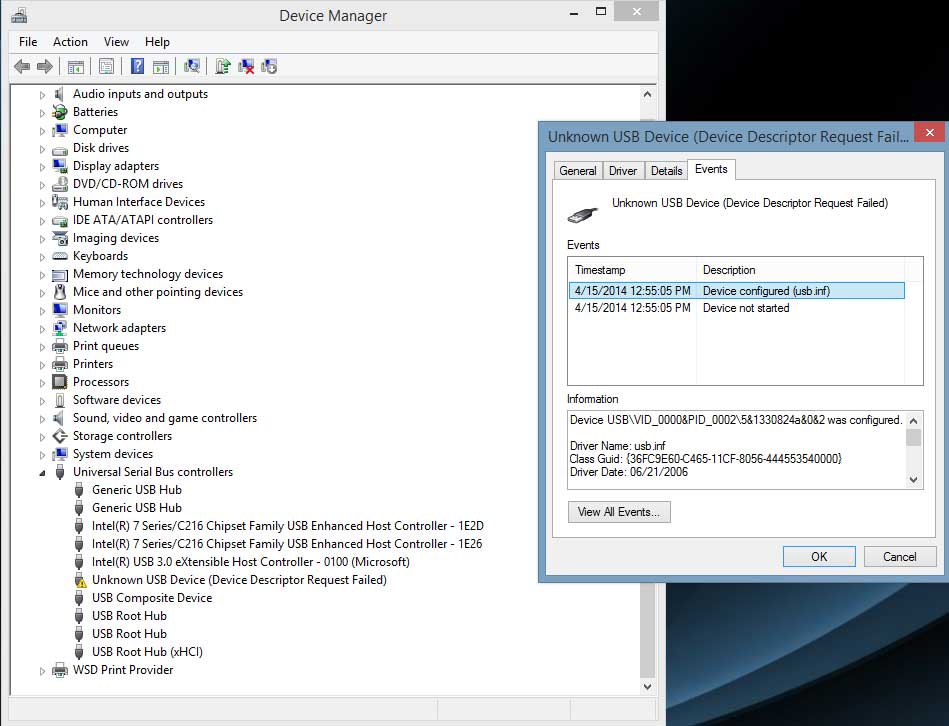

Hey T5BRICK, Yeah, I've checked the lightning port and there's nothing there. I've put the device in DFU mode and tested on two PCs and I would get an USB not recognized message (see attached below). To make sure, I'd borrowed my mother's jailbroken iPad2 and tested on the two computers and both recognized the iPad. I don't know what else to do anymore except going to the Apple store and hopefully they give me a replacement since I'm still under the 1 year warranty.
[url=http://i297.photobucket.com/albums/mm205/redflamestudio/error1.jpg]Image[/URL]

I guess I really don't understand why you are so persistent on the OTA update feature on a jailbroken phone. It's disabled so that way you don't accidentally update and so that way a downloaded update (which you cannot install if you want to remain jailbroken) doesn't waste any unnecessary space. Anyway, on to your specific issue....
This typically happens on older iPhones when the 30 pin connectors have been bent, broken, or are filled with dust. I don't really have a lot of experience with the lightning connectors so I can't tell you why this has happened (multiple times).
Have you tried pulling updated iTunes drivers out of the iTunes program files folder? I know you say you've tried different computers but you may as well give it a go.
C:\Program Files\Common Files\Apple\Mobile Device Support\Drivers
Right click the usb device with the exclamation point in device manager. Update software. Have disk. Point to the location mentioned above.
