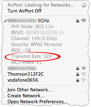

It's all going to depend on your location when you transfer. I'm in the next room over from my Extreme Base Station and using the 5GHz network, I get a transmission rate of 324Mbps.

Option-Click your Wi-Fi icon in the menubar to reveal details of the network you're on.
It tells me I have 405 in my dedicated 5 GHz network... But I'm not getting those transfer speeds 🙂 I'm guessing transmit rate would be the theoretical max, and not having anything to do with actual transfer speeds...
That's not the true transmission rate you get across your network tho - to measure that you'll have to actually transfer some data and measure how long it takes. Chances are high it'll be far, far less than what the pop-down menu suggests...
