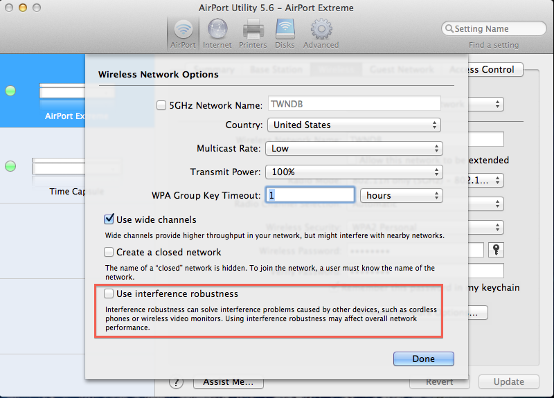

Do you have interference robustness enabled? There could be a lot of other people near you (maybe) that have routers on the same band. Are you using Airport Utility 5.6 so you can still use the advanced features?

Hmmm... that stinks. I have it on my iMac which has Mountain Lion, but I installed it when Lion was on it so it got migrated. I just tried to install it on my new MBP with ML and got the same thing you did. That's unfortunate because the new AirPort Utility isn't very good lacking the advanced settings.
Edit: Do this; I just did it and it works. 🙂

Here it is...

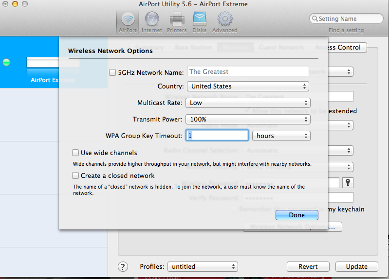

Channel 10 worked great, but then went slow again!!! now channel 4 is way better, but I had to disable "use wide channels" (look at attached pic from post)..
