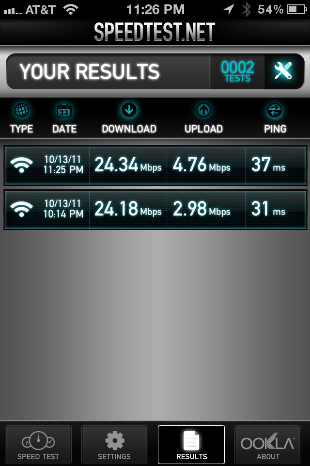

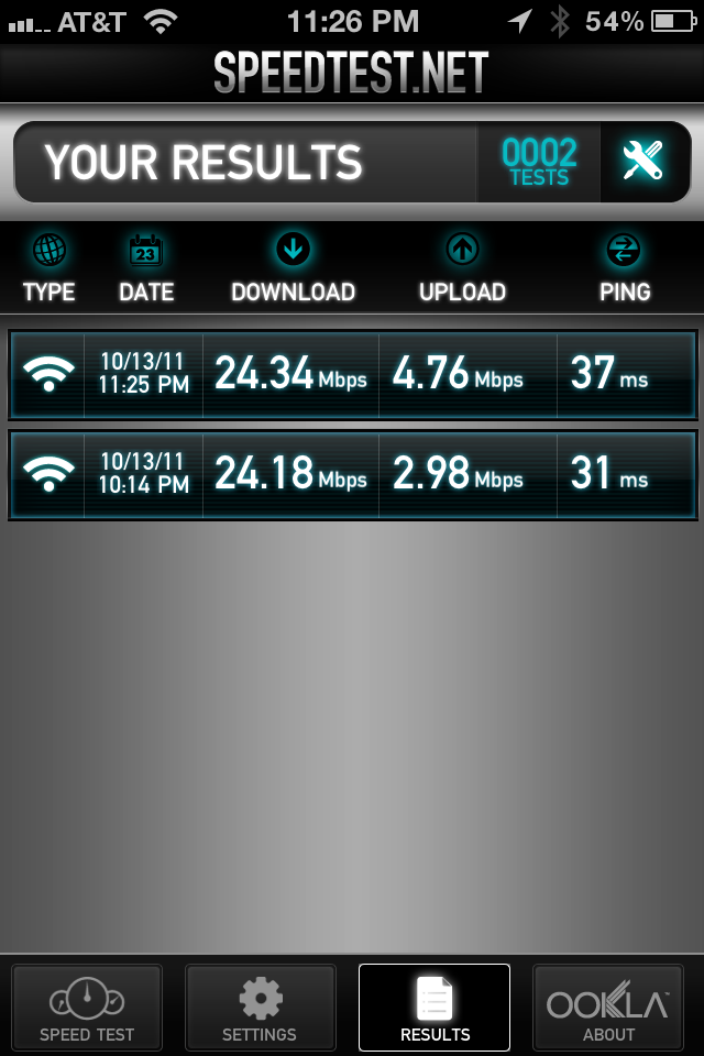

My 3rd Gen is in the front right office and does just fine and I get full signal every room in the house and 2 bars in the backyard and house is just over 2400 sq ft.
