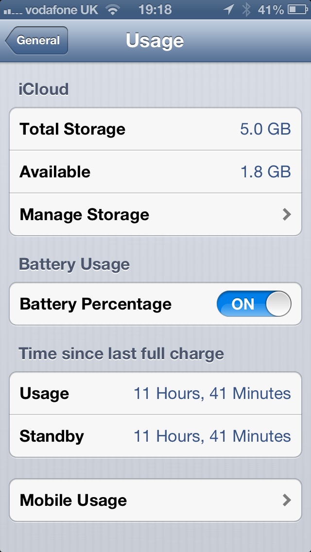

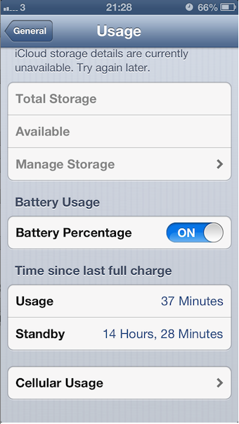

My usage and standby have been the same value all day, increasing together.
Does that mean my ip5 isn't now going into standby? I used to get two days out of one charge, it now goes on charge every night...
yes, it does mean your iPhone is not going into standby.
Do you have a exchange account? If so delete the account and add it back. Others, along with me have found a corrupt exchange account to be the culprit.
