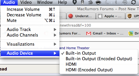

That's "my set up" well not mine really my parents I have my own 5.1 set up in my room which again my MBP does not like because I have no way of really outputting it. VLC gives me the option to output the audio via HDMI decoded but it does nothing....help?

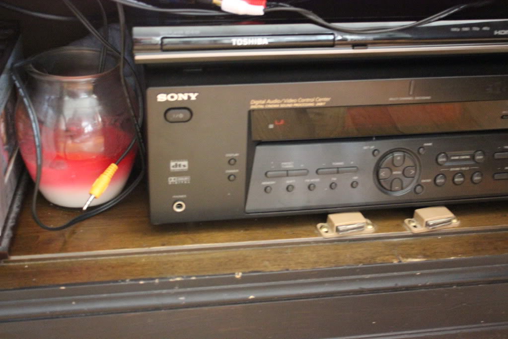

Here's the deal;

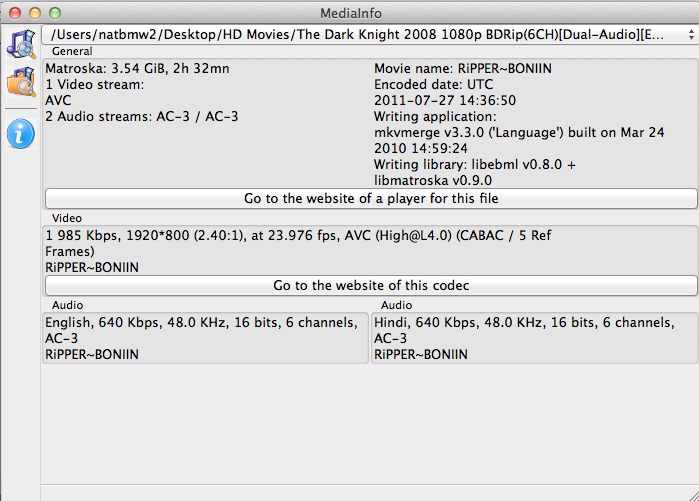

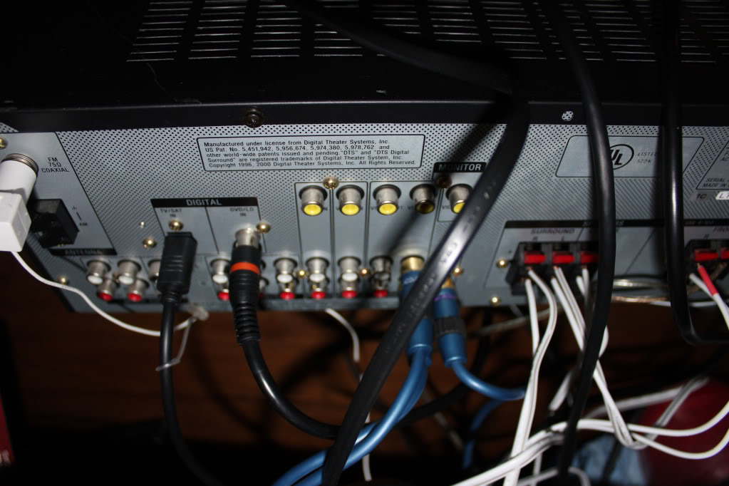

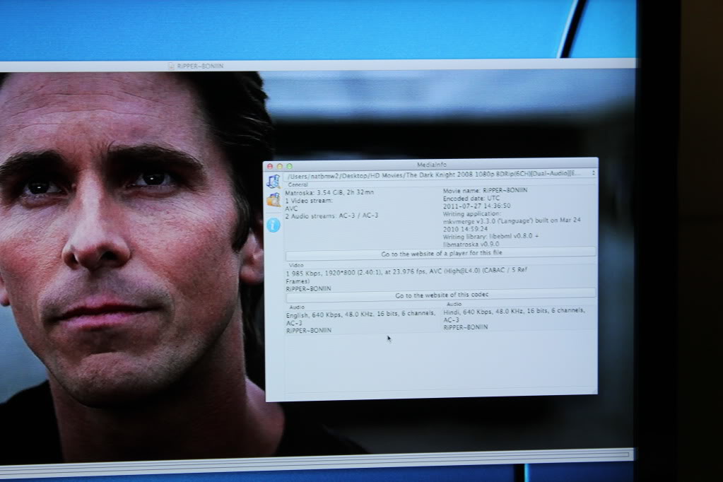

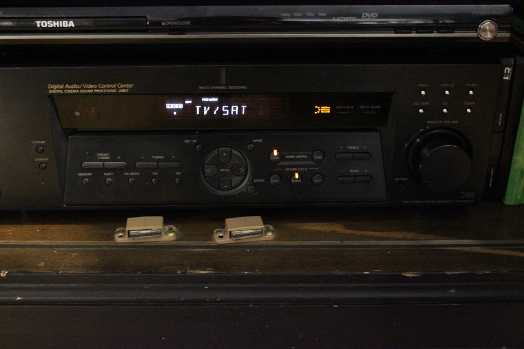

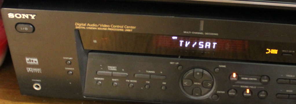

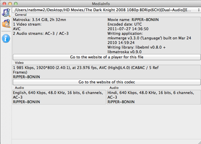

Playing The Dark Knight BluRay rip on my Sony surround sound system via my MacBook Pro using VLC. I have the Audio outputting via my MBP's optical out and directly into the surround sound since my Toshiba 46" LCD for whatever reason will never play sound under any circumstances when plugged into my mac. I have the surround sound hooked up to a front center, front right, front left, surround right, surround left and a sub but it will only play over front left, right and center and the sub. I have screen shots below regarding what it displays....
Really don't understand I've seen older MacBook's play this kind of stuff...help? I've tried both encoded settings as well as non-encoded settings.....I want full 5.1 surround at minimum :/
You said it's a rip off blue ray, any chance you left out some of the surround sound settings?
I don't think so...?...Look at my screen shot attachment...it looks pretty solid to me...besides I tried other content that was specifically labeled like "5.1 surround sound test" "7.1 surround sound test" and got the same results.... :/
