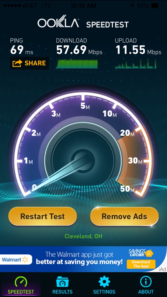

LTE speeds 1.28 DL. 11.06 UL.
Ridiculous! Now I gotta find an Att store on the way home.
