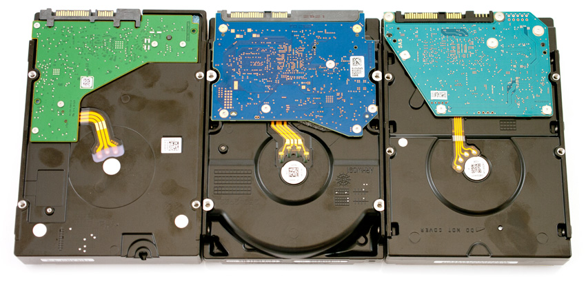

Here's an article on the problem:
http://www.storagereview.com/6tb_hdds_causing_problems_for_system_vendors_but_not_the_way_you_think
But the gist of it is that new 6+TB drives omit center screw holes on the drive, and the Mac Pro (and NAS' like Synology) expect to use those center holes. This is a real problem with the Mac Pro as only the front screws can clip on and the drive would wobble dangling downwards.
