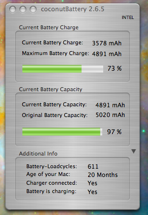

This is my main computer. The only other computer in our house is a 1991 gateway that still runs only because it was never plugged into the internet. Although I did get it working on wireless a week ago and its actually quite fast.
Anyway, this is the main computer in my house. Everyone uses it so it gets charged quite a bit and used a lot. How bad is this on my battery?

You have 97% capacity after 611 cycles? That's actually really good. I have 97% on my macbook after 90 cycles
The health looks good but 500 cycles is considered the average lifespan so be prepared to buy a new one.
I've always wondered about this... not too long ago, both notebooks and cell phones used relatively similar Li-Ion batteries (and increasingly both use similar Li-Poly batteries). On the computer, it was assumed that 300 charges back then was about all one could expect. But we would all routinely have cell phones that we'd run down every second day, and use for two years this way, straight, which comes out to 350-400 cycles, and they would still have little, if any change in capacity.
Based on your usage stats, you're essentially using the battery for a full charge every day. I dunno. Maybe there's some benefit to this regular use vs. most of us who are always using our notebooks on wall power. I wouldn't lose sleep over it.
In the worst, you're getting excellent use out of your battery and if/when it does go bad, you just buy another one and get this one recycled.

I would go with the don't bother... your Cocoanut shows you're at 97% life, right? What is your actual battery life like? Is the notebook running for about as long as you expect it to, or is it only lasting a couple of hours?
Assuming that you're getting somewhere around the rated life... this situation is like those people who are 102 years old and have been smoking for 60 years. Yes, smoking is bad for your health. No, you should not smoke. But if someone has lived in excess of what most people lived, already doing what they're doing, then one way or another it's worked for them.
You've used your battery in excess of what you should expect from it, and the battery seems to be functioning quite well. If you're getting the hours from it you expect, I'd say, why change anything? Just do what you're doing.
