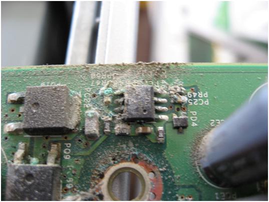

Yucky corosion should look like this :
To take off the corrosion, use a small q-tip type thingy, dip it in rubbing alcohol and rub it against the corroded contacts. Then be sure to rinse it again with a q-tip and just water. Then leave it to dry for a long time before putting everything back in. 😉
Depending on the corrosion, it's quite possible that it could slowly deteriorate the metal it's on, making it unusable at some point.
Sorry to correct you but that doesn't look like corrosion to me. That's more likely to be fine dust from the exhaust fans.
