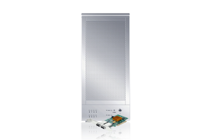

First, you have to share what the hell you are doing that needs 15TB of data! 😱
Then assuming it's not just a large p0rn collection 😛, I would go with something like this...
http://www.sansdigital.com/towerraid-plus/tr8xp.html
  • Complete RAID storage solutions, no extra component needed.
  • Supports Eight 3.5-inch 6G SAS or 6G SATA hard disk drives.
  • PCIe 2.0 x8 6G controller allows the offload of RAID calculation to controller card.
  • Supports RAID 0, 1, 1+0, 5 and JBOD with hot spare.
  • Easy to setup Web-browser interface.
  • High Performance delivery over 650MB/s read write performance.
  • Cable-less backplane design supporting the hot-swap of SATA 6G and SAS 6G hard drives with removable trays.
  • Supports plug & play for easy installation.
  • Compact enclosure with dust-free cover.
  • Supports PC, MAC and Linux. VMware ESX/ESXi 4.0 supported
- CalDigit 16TB HDOne RAID
Avoid this like the proverbial plague. You won't be happy with tech support.

It uses a Highpoint RR2722, which isn't the best brand to go with. The enclosure itself is great, but a better card by a different maker would be in order (better tech support, performance, and stability). 😉

Do you know if the fans are quiet in the unit?
The Sans Digital units are typically quiet. And worst case, you can swap the fan out for a quieter unit, such as Noctua (done this before with such enclosures).
What would you suggest for a better controller?
Areca, as it has the best price/performance ratio. ATTO is good as well, but it's more expensive when comparing equivalent models between both of these brands. ATTO would be a bit easier to deal with Customer Support, as it's based in the US (NY to be specific), while Areca is based in Taiwan (but they do speak English and know what they're doing; they design and manufacture what they sell).
If he just wants to use this as a JBOD enclosure (assumption here) wouldn't this card be plenty good enough? However, if he wants to run a parity RAID array... I agree with you.
