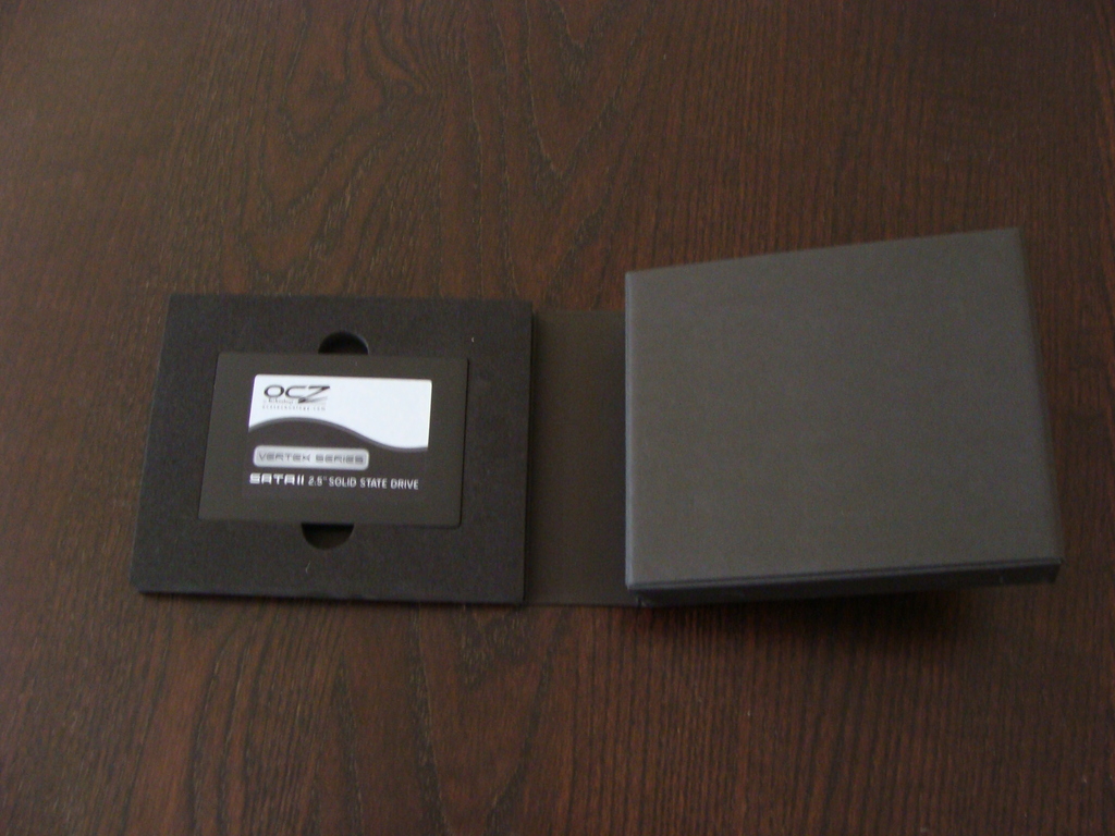

Woo hoo ! Just got my Vertex 120GB yesterday.
Inside is a plain black box. Looks like OCZ is learning from Apple.
Kinda reminds me of the iPhone packaging.

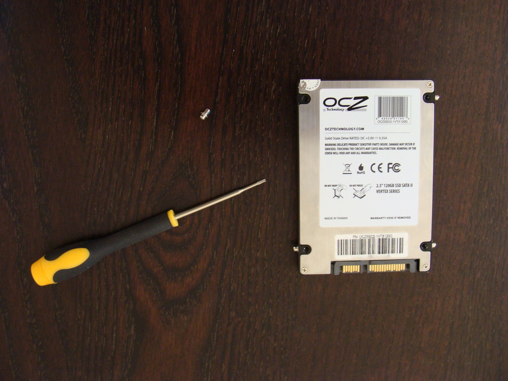

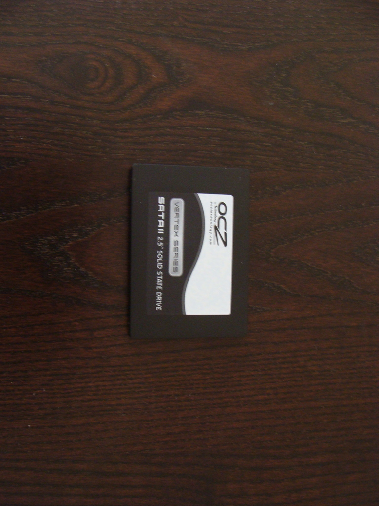

The drive itself:
This replaces the current WD Scorpio Blue 320GB in my Macbook 2.0 GHz
Installing the Vertex couldn't be easier, but one has to use the 4 Torx screws so that the drive fits into the bay
And that's what it looks like ... fitting snugly inside. I think I like the sleek black :)

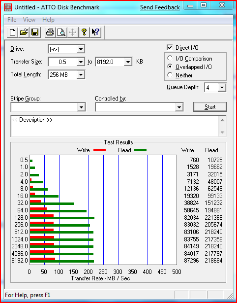

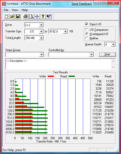

And finally ATTO running in Win7. Remember ATTO gives funny results when run on the system drive.
After torturing the drive with a few installs and what not, I ran ATTO again ...
It looks like write performance has gone down from 110 Mb/sec to 83 Mb/sec but even after further installs and usage, this value was stable.

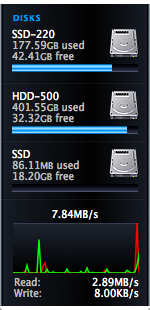

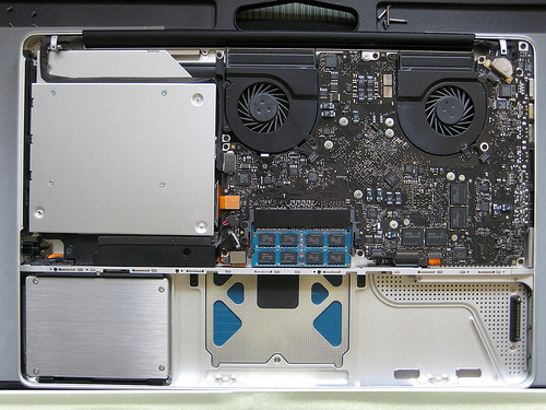

Regarding the bigger drive...
For those who can live without SuperDrive.. There are alternatives..
It's MCE OptiBay.. The price is not so cheap though.. $129
Then I bought the cheap enclosure and cheap SATA-to-USB so that I can still use the SuperDrive as external drive.
Or if you're handy, you can get the Slimline SATA plug and hack the connector together for around $20-30. But still need to find a way to secure the HDD inside.
I planned to replace the HDD with another Samsung 256GB SSD and do a RAID0...
