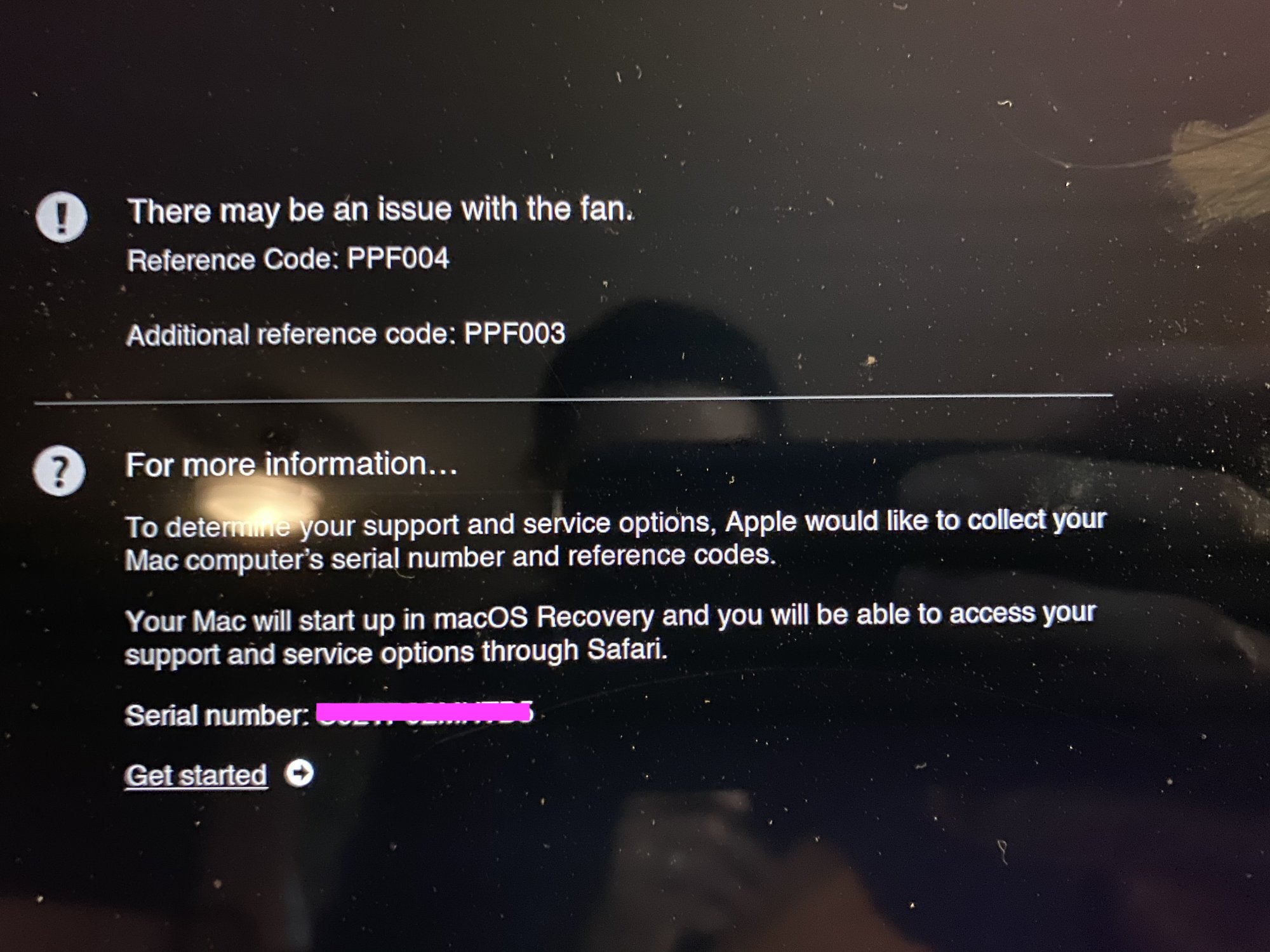

When I was having the windowserver errors while using both MPX + 6800XT, the Apple Diagnostic Test threw this error:
Once I removed my MPX altogether and kept just my RX6800XT, I stopped having issues, and passed the Diagnostic test without any issues, so in my case it was the Vega that was causing problems...
