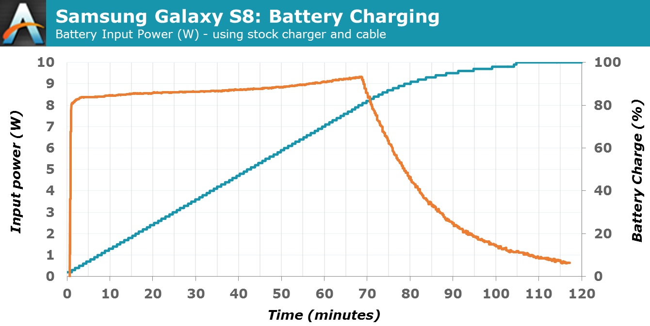

This is how fast charging works. It's the same in competing phones as well. It's much easier to fast charge a battery to the first 50% of capacity. After that, all phones taper off quickly and the total charge time may not be all that different.
Test like those done in the video aren't accurate because there is a limit that the charger can provide to the device's battery. If the device is in use in any way during the test, some of that power goes to powering the device, changing the total charge time.
https://www.anandtech.com/show/11540/samsung-galaxy-s8-exynos-versus-snapdragon/5

The Plus model phones have been known to support fast charging with the 10/12W iPad adapters for years. It could be that Apple is allowing them all access to the faster charging in the 29W brick, not restricting it to the 8+. Apple just never advertised the previous 'fast charging' capability.
Using the phone can mean background tasks one doesn't even realize are operating.
Anyhow, his data doesn't match other more reputable sources that show the 8+ charging to above 50% in 30 minutes as advertised. Clearly faster than the S8 I posted above which takes 42 minutes to reach 50%. http://appleinsider.com/articles/17...ing-speeds-with-fast-charge-wireless-and-more
Wow ok, those are completely different results from the test in the video. It shows the 8+ to be fully charged in 1.5 hours, pretty good. I have to trust your source over the YouTuber on this one. Thanks.
