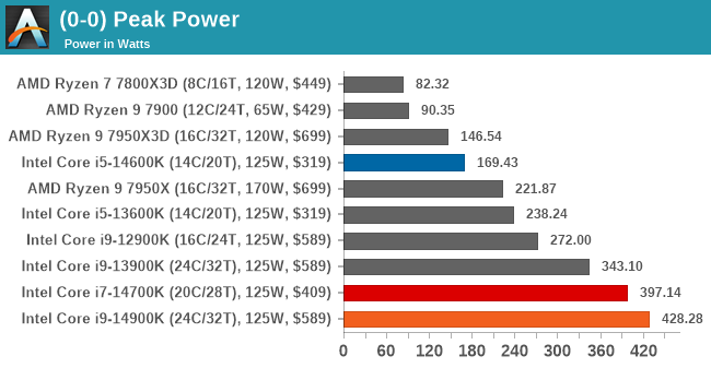

Turns out when you stop caring about power consumption you can do a lot.
It’s frankly both pathetic and embarrassing to be pulling that much power, and is a sign of how bad Intel’s arch is, but hey, if you want to be 6% faster than AMDs fastest at the cost of an extra 200W, you can do it.

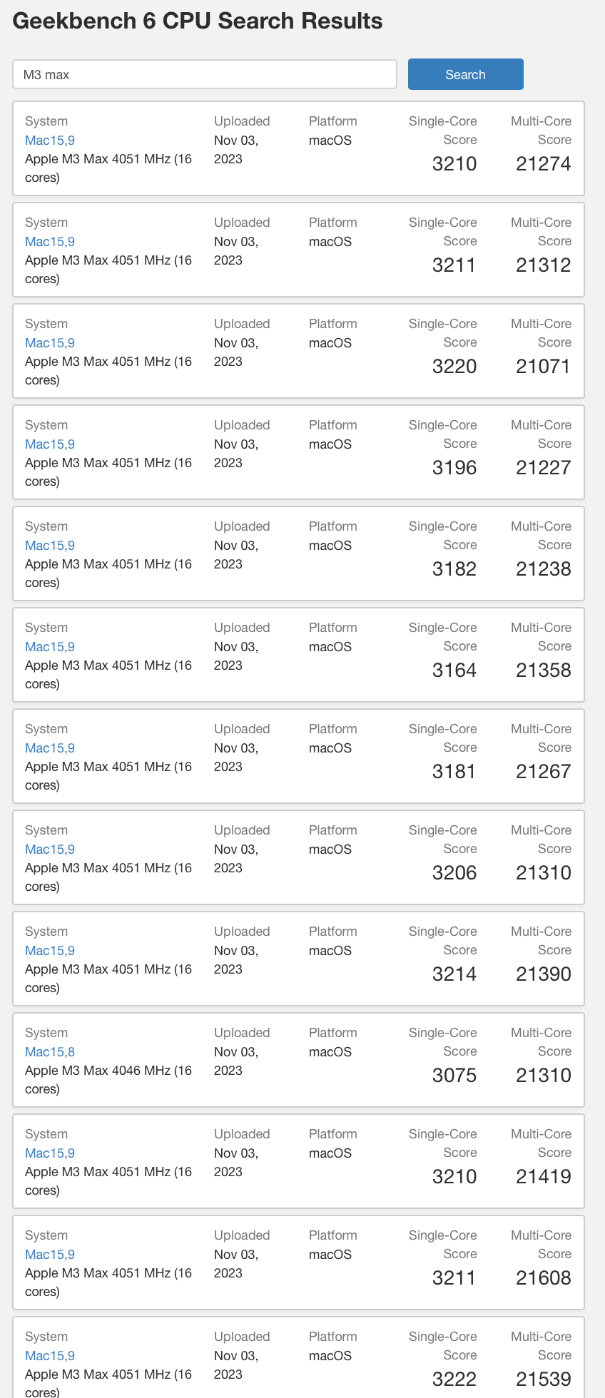

I just did a search for M3 Max on Primate's website. Here's the start of the results--the most I could squeeze into a screenshot on my MBP's screen. Just by eye, the SC scores average >100 points higher than the lowball score Zest28 posted.

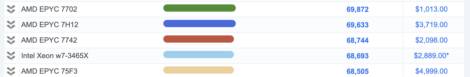

The problem with these multi-core scores is that they don't account for multi-core tasks that actually have interdependencies, which is something that was addressed in GB6. For instance, here we also have the old $1,000 64-core AMD EPYC 7702 (released Aug 2019) outperforming the newer $5,000 32-core AMD EPYC 75F3 (released Mar 2021). So if you have a bunch of separate task that you can run on separate cores, and just need to throw a lot of cores at the problem, this benchmark may be useful--but only if the limited types of tasks it incorporates correspond to the types of tasks you are doing yourself.

Well, I surely hope that Intel's high-end stove-like gaming desktop CPU will outperform Apple's laptop computer. Actually, this is starting to get a bit embarrassing for Intel. 5-10x more energy for the same performance? Yikes.
