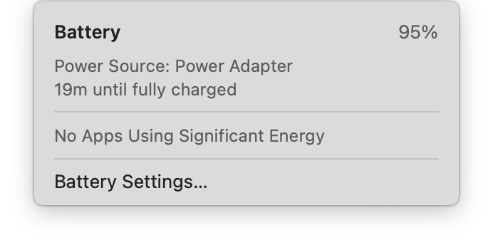

I restarted my MacBook with the MagSafe charger and Element Hub both connected. As expected, it started charging from 80% back up to 100%. However, when I click on the battery icon, it doesn't say "charging" even though it is charging. Is it supposed to say "charging" somewhere while charging?
It says it’s charging when it says “xm until fully charged”, in as much words.

True, but if I recall correctly it used to say "Charging" right after where it says "Battery".
