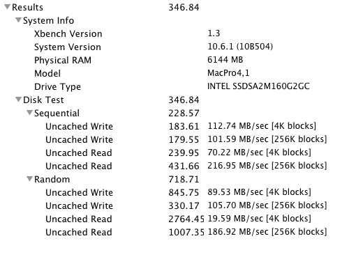

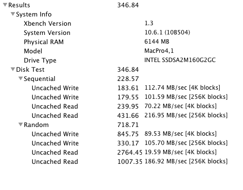

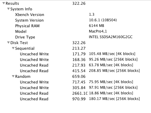

I just got this from xbench (Snow Leopard 10.6.1), before and after i did the firmware ugprade with trim support.
