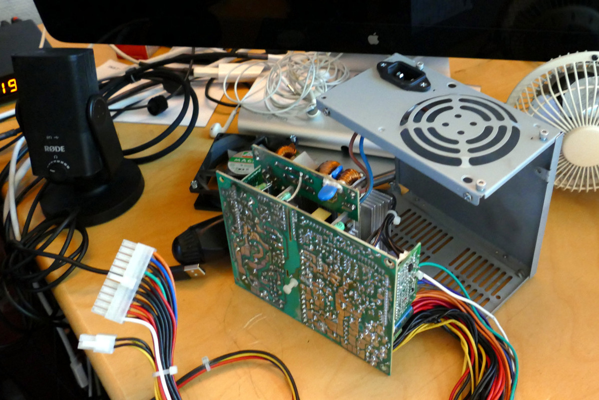

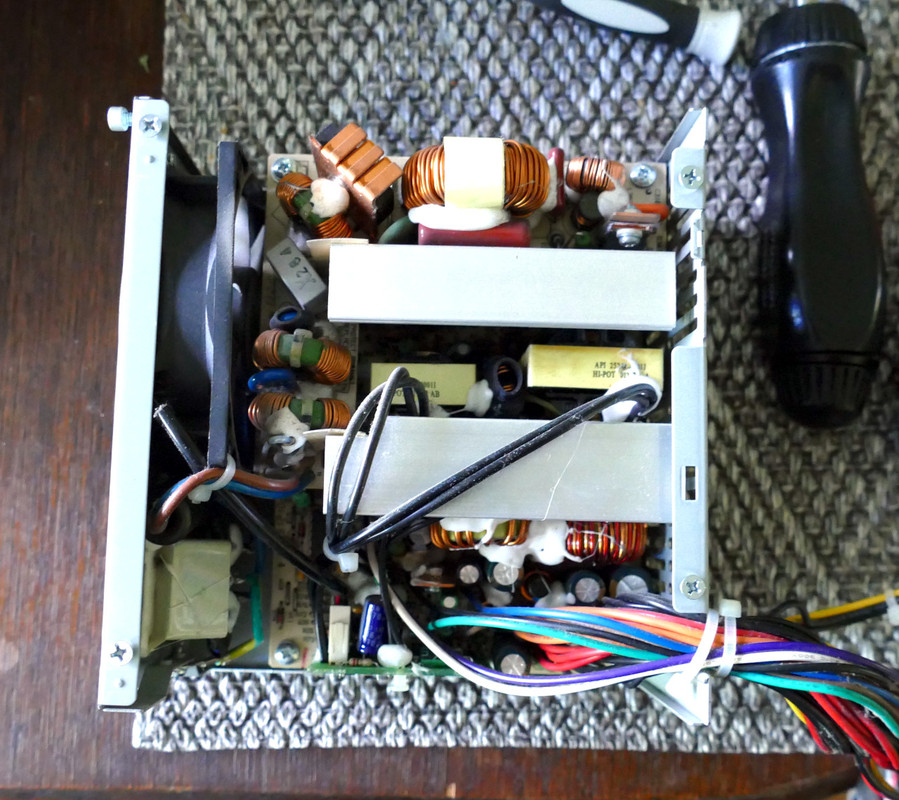

IMO not worth of a new thread so I'll continue this old one. So, here is my new Quicksilver 733MHz's bad AcBel 344W PSU.
Nice how tightly packed it is and how much they used the white goo everywhere. 😕 And Apple sure likes screws, parts do not fall out by accident. 😉 EDIT: I see there are several revisions or models of this PSU which are little different in layout and components.
So, I'll give a recap a try. Didn't find a cap list for it so I'll have to take them out and find out. The ones I can see in situ look the same spec as in MDD AcBel PSU.
I do have an old 450W ATX PSU as a backup and I did order a 20pin to 24 pin wire adapter for it. I didn't find the ready made ATX to Quicksilver -adapters anymore so I'll have to do it myself, if I cannot get the original psu back to operational.

Yes, I have read that and many more threads searching for info. There are several revisions of the QS AcBel 344W PSU and mine doesn't match the cap lists I've found.
Compared to the pics on page 1 and the list on page 2 mine has 1 more TEAPO cap and the fan controller board only has 2 caps instead of 6. Well, I went the old way and mapped the caps manually. There are couple I cannot see until I take them out but I have now ordered the rest.
