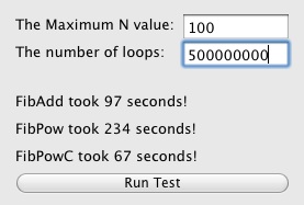

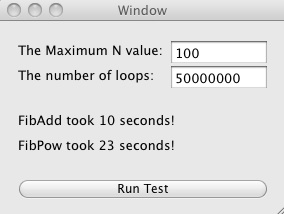

I just wrote a program that illustrates it.
Source included. Here is a screen grab.
Basically you can specify the Maximum N for Fib_n, but remember that they are all ints in here so 200 is about as high as you could want to go.
And the number of random times it tries. Since the numbers are random, you have to do a lot to get it to be "fair" between the two. (we'll call this X)
It then makes two objects, one calculates X Fib_n numbers with my additive algorithm. And once with my naive Pow function and those darn floats specified by the above sqrt(5) functions.
You'll see that the Pow function takes a little over twice as long in my simulations... with 50million random Fib numbers.
EDIT: I should have made them unsigned, but oh well
EDIT2: the ratio is pretty close to 2.3x I have run it at 500mil and gotten 97s and 232s

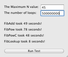

I have rewritten it to include a new class named FibPowC, guess what? it replaces my naive pow function with the math.h pow function.
It is much faster than my bad power function. In fact it is even faster than my add function.
Goes to show, your algorithm is only as good as its weakest link.

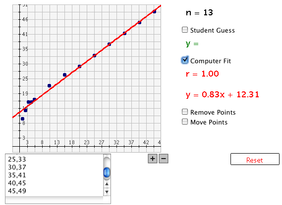

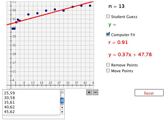

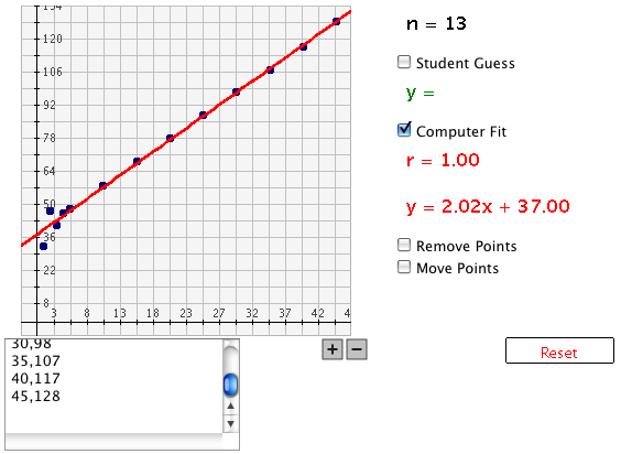

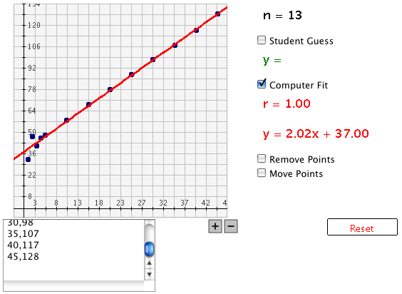

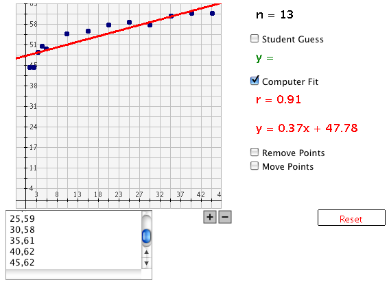

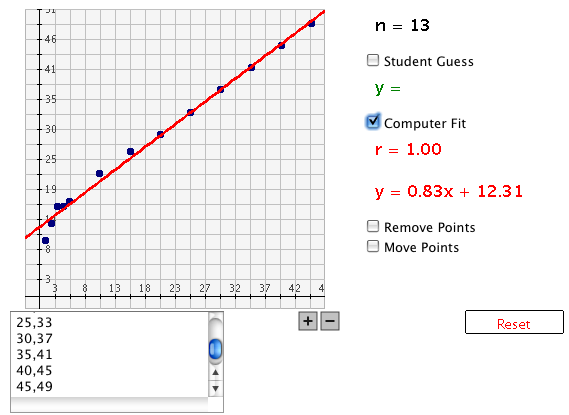

Here are some plots of the data points I've taken. Each n is the degree of Fibonacci(n), and the plots are in seconds. 500 million random F_n's are calculated using each method.
The order is FibAdd, FibPow, FibPowC. It looks like FibPowC will certainly be a better function in the long haul, but has much more function overhead. Over the range of that is relevant using unsigned ints (N<46) FibAdd wins hands down.
FibAdd = 0.83n + 12.31
FibPow = 2.02n + 37
FibPowC = 0.37n + 47.78
EDIT: I'd just like to take a moment and say that my hypothesis of Nadditions being about twice as fast as 2Nmutiplications seems correct, that was I guess was the point of all my nonsense today.

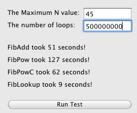

Added table lookup class. Basically the table lookup class populates an array of unsigned int's with the sequential values from an instance of FibAdd (before the timer is started for the record). Then the method fib_n: (int) n, just returns the value from the n'th array.
Unsurprisingly it is by far the fastest. But doesn't make sense for anything larger than F_45, as you couldn't hold it in an unsigned int. Thus you'd have to make arrays of larger memory foot print things.

I changed the algorithm in this test program to a single pow call for FibPow and FibPowC.

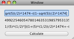

On a side note, a while ago I wrote a program that takes an NSString and does the math inside it. I never wanted it to be so accurate, but check out the highest it can go without hitting infinity.
Screen grab of that program, and of Wolfram Alpha doing the same calculation.

I cannot think of a way to extend this accuracy to FibPow or FibPowC using standard data types and retaining accuracy.
Treating the data type as double the whole way of course gets us higher "looking" numbers. But at the same depth returns ...
12200160415196712960
off by 75million.
