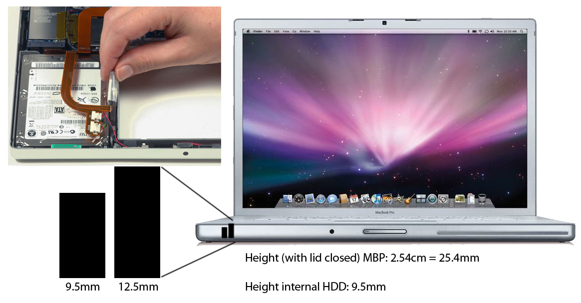

    Also no airflow is not that good.
    See this self-made comparison of the third grade kind.
    [​IMG]
    And a look at this guide:
    http://www.ifixit.com/Guide/Repair/...Inch-Model-A1150-Hard-Drive-Replacement/486/1
    You could get an external FW800 enclosure for 2.5" drives and put a 1TB 2.5" drive in there if you really need that much storage on the road.

    So then, i should not get it because of airflow..? I'm sorry i am just completely confused on this one because on the internet people are saying it works fine and people are saying it does not..
    EDIT: Oh okay i see.

    A 3mm difference might seem really small, but in terms of percentages 12.5mm is 31.5% bigger.
    If you need that much space, get the WD Scorpio Blue 640GB. It is 9.5mm high, with only two 320GB platters. I read somewhere that because there are fewer platters, the data is more densely packed and seek times are shorter.
