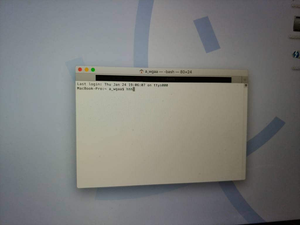

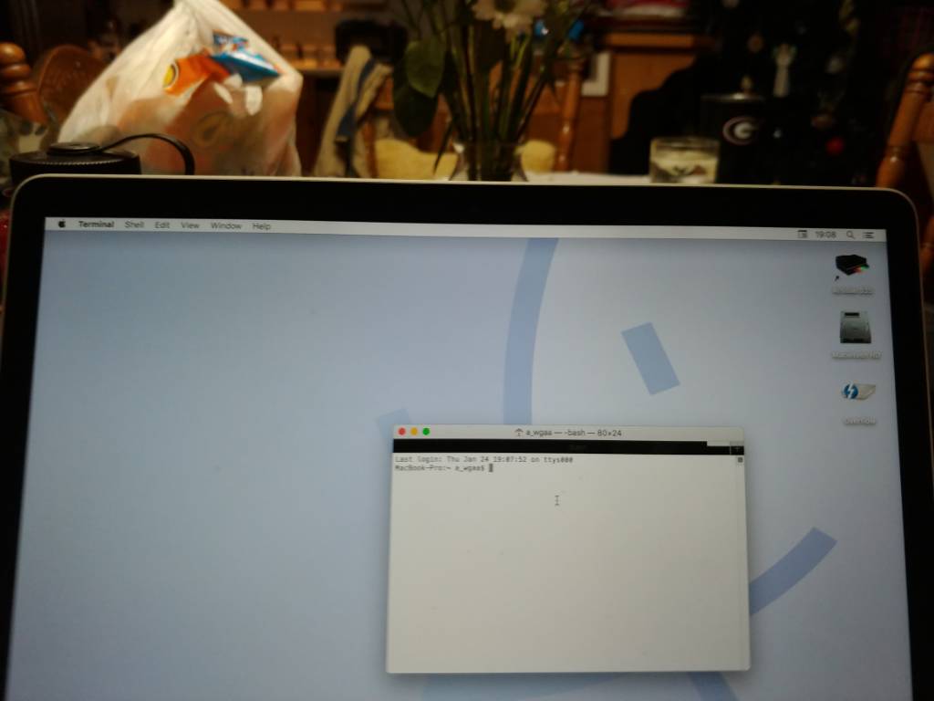

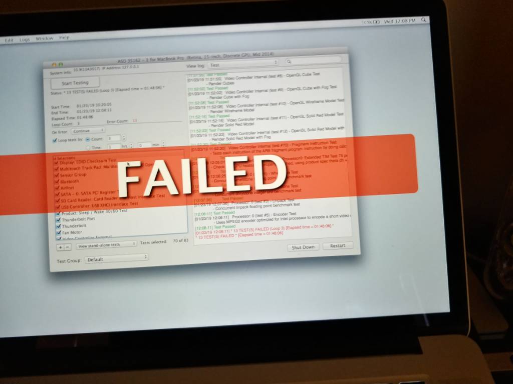

And it gets worse.
The first two first are of Terminal open in safe mode, and the second one is the result of running Apple Service Diagnostics.
And no, 10.14.3 did not fix any of the problems from 10.14.3. :(
I would upload the report, but I'm posting from my phone.
Reactions: AnonMac50
And it gets worse.
Where did you get the test from? I had one I used on my old 2008 MacBook Pro when my Nvidia was failing (luckily it was covered under the repair program). Unluckily, my 2013 MacBook Pro with the 750M also developed problems that I had to pay out of pocket to repair (a cost of $910 AUD). It failed all of a sudden, so I had time to prepare for it. If the test fails, a software update won’t fix it I believe, and you have a hardware issue.
