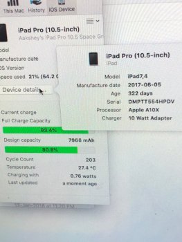

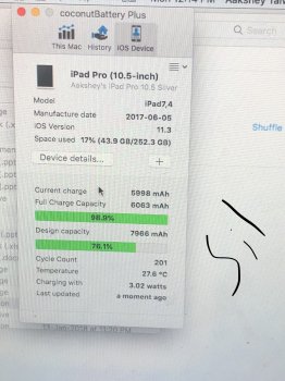

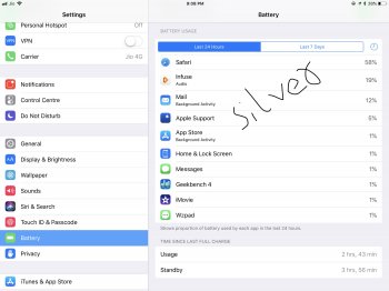

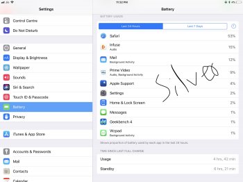

Hi guys,
Is this normal?
iPad Pro 10.5 LTE 256 GB Silver bought in late June 2017.
Acc to Coconut Battery Plus:
Currently at 201 cycles.
Battery health 76.1%.
Always charged using official Apple 29W charger and cable bought from an Apple store.
Lasts 4-5 hrs at 30-40% brightness browsing and watching videos, on WiFi. Sometimes less than that.
Already being throttled according to Geekbench 4.
What should I do?
Still under 2 yrs AppleCare but they say this is fine. 🙁

I’d try to speak to someone a little higher at Apple.
Their page used to say that the batteries should retain 80% of their original capacity for 500, or 1000 charges I think it was depending on the product. It now says:
“Apple lithium-ion batteries are designed to hold at least 80 per cent of their original capacity for a high number of charge cycles, which varies depending on the product.”
It’s a little less specific, but if it were me, I’d definitely be be speaking to them if my device was only holding 76% after 200 cycles.
They’ve done the Mobile Resource Inspector test and their test shows 87% at 201 cycles.
Do they have any other tests in UK? In India they don’t.

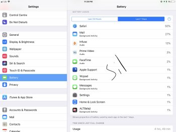

The battery doesn’t even last 5 hrs with 30% brightness just doing Safari and mail. So obviously Apple’s diagnostic is wrong.
And ya, Geekbench is down to 8000 for multi core compared to 9300. But they don’t acknowledge third party benchmarks. And they haven’t created one of their own yet.
Reactions: ShaunAFC3

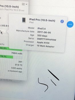

Note, as mentioned fast charging is kinda bad for battery. That was one of the reasons I decided to skip buying the 29W charger + USB-C cable.
I don't have a Mac so no access to Coconut Battery but per Battery Life app (yes, it's not as accurate), my 2nd gen iPP 12.9 is still at 100%. I just charge with a 12W charger.
For iPads, it's 80% battery at 1000 charge cycles so 76% at 201 cycles should definitely be eligible for battery replacement. Problem is Apple's software reports 87% so sorry, can't help there. Have you tried contacting online support with remote diagnostic?

Remote diagnostic done by Apple takes the average health over the last 2 weeks when determining the number. Coconut battery is real time health. So if the battery has failed in the last 2 weeks, then it wont show up on Apple's test. Give it 2-3 weeks and contact back. The battery is definitely failing or has already failed.
It has been under 80% for over a month.
In India they can only do a remote diagnostic.
When I visit London ill try for a more accurate test at Covent Garden.
