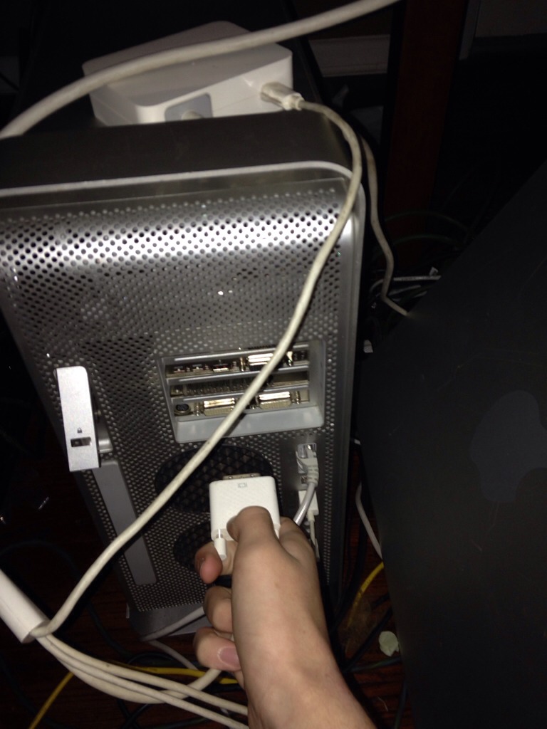

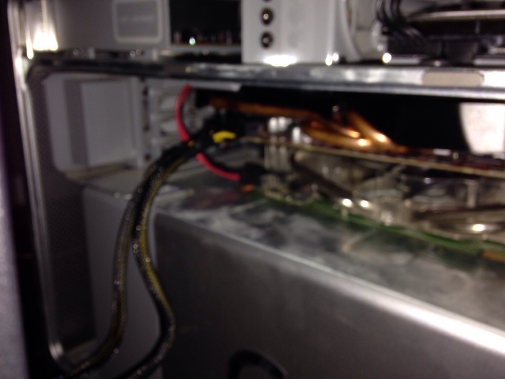

I have debian installed and am going to stick the 7970 in the x8 slot and use my 7800GTX as a helper card. We will soon see how it goes.
It is now installed

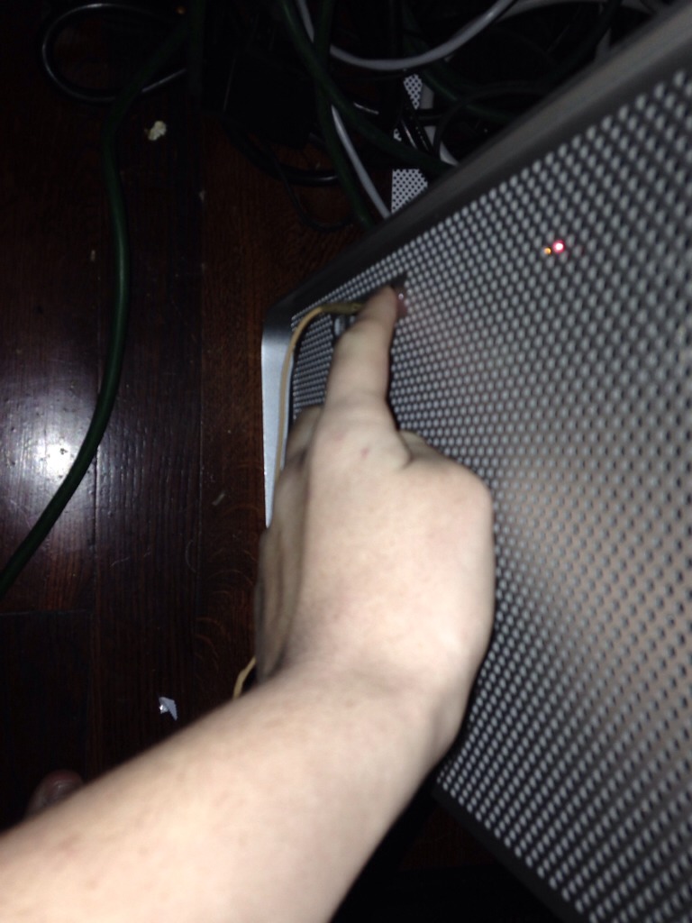

Power button pushed
Chime heard

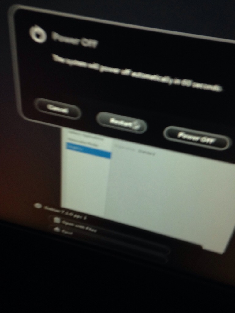

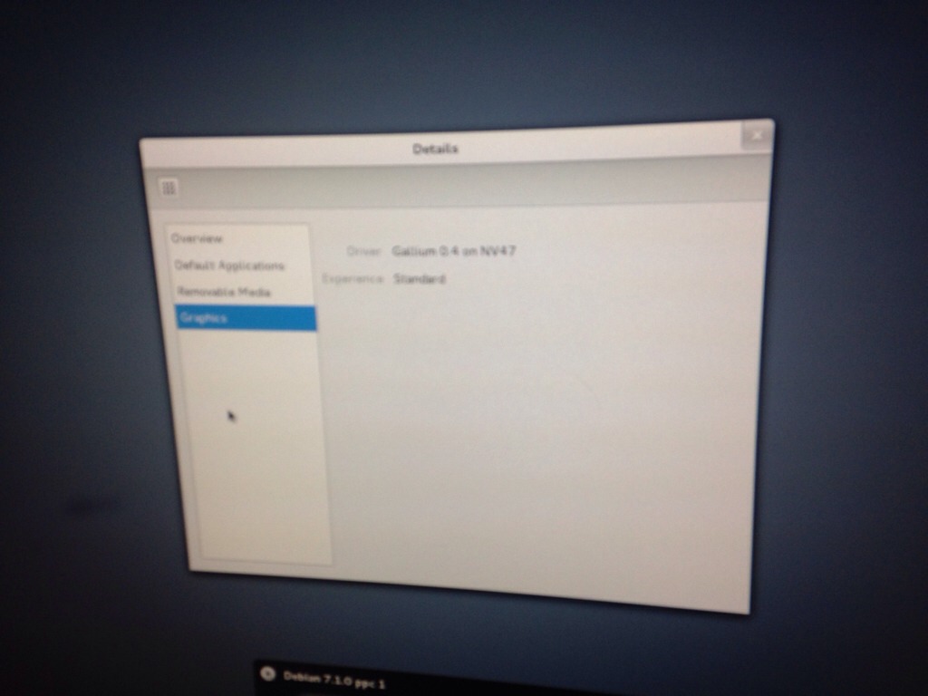

nVidia assistant card is doing its job.ImageUploadedByTapatalk1376093398.011448.jpg
*remembers PC isn't on*

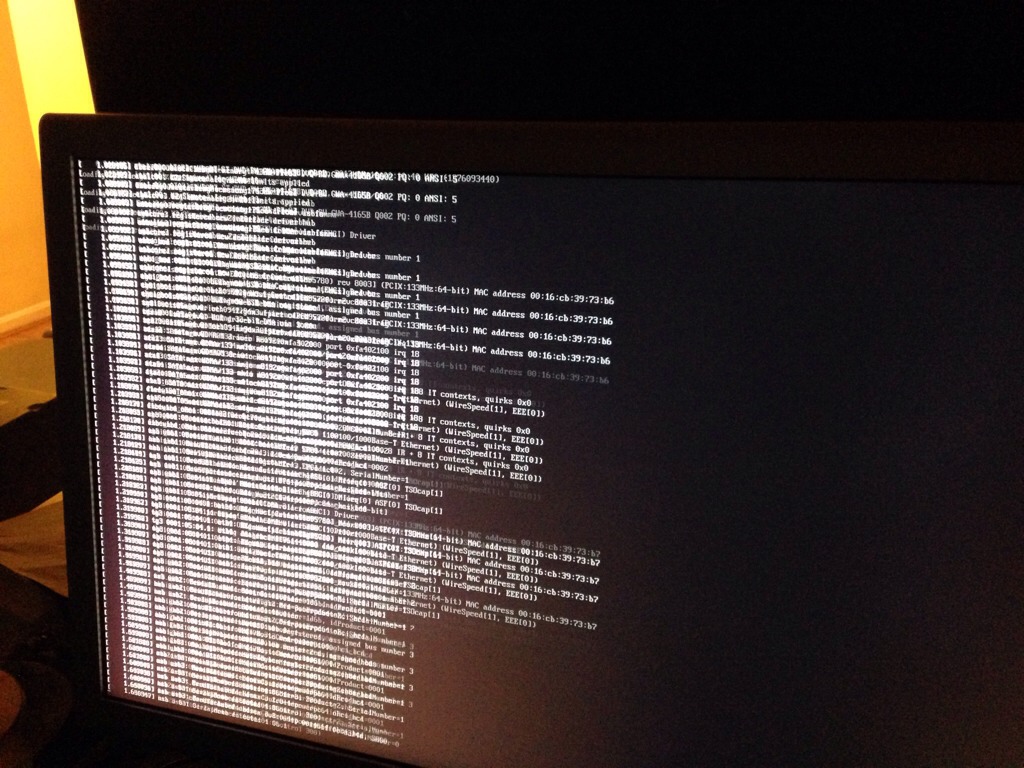

Display now hooked on 7970.
No signs of life.
Waiting for linux to pop up.

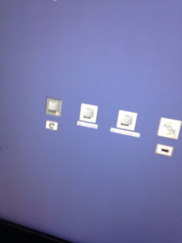

Was not booting, display now on 7800GTX, I am at desktop.
7970 is still not detected.
