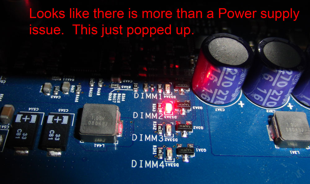

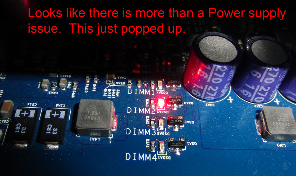

My testing has been done with just 2 modules of ram. After I pulled the Graphics card and it all started up I began putting it back together. So I placed all 6 modules of ram back in. I now see that one module is out. I pulled the bad module out and one good module out, So not only could it be the PU but I have some bad ram.

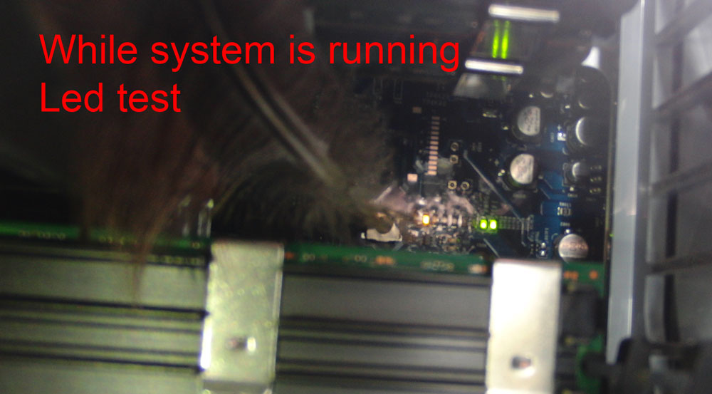

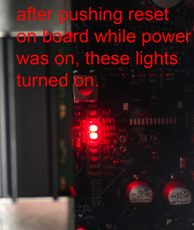

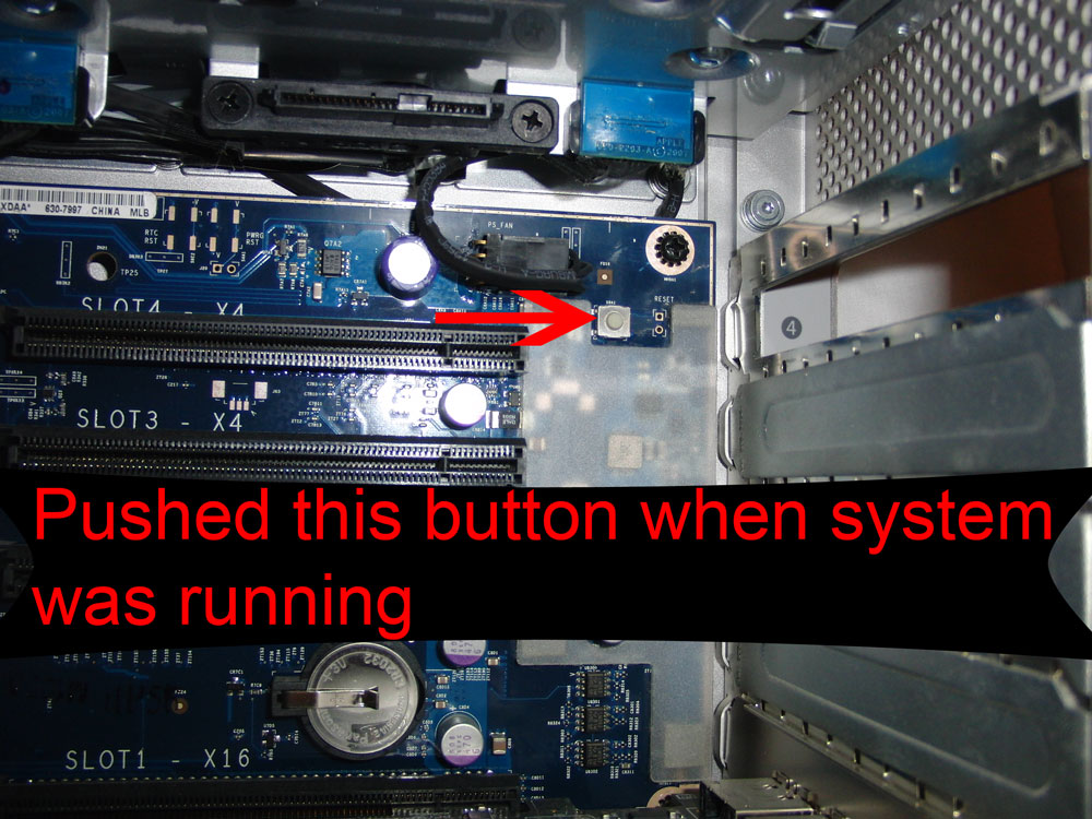

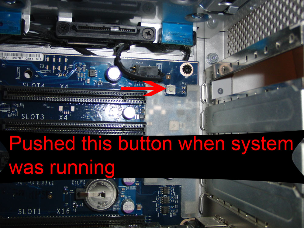

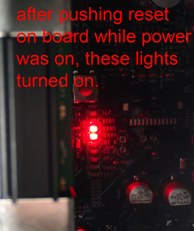

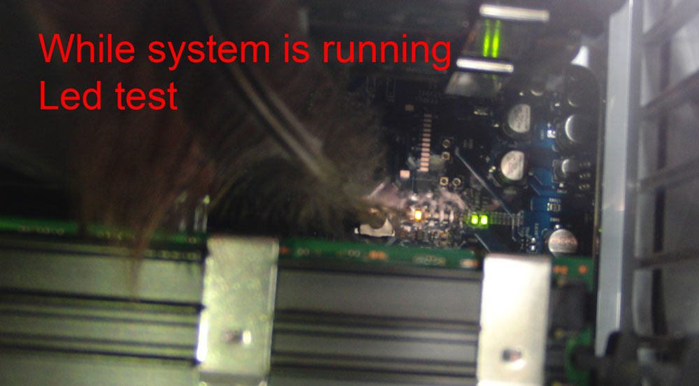

I also pushed the LED tester on the mother board and I got a yellow and two greens. Than while the system was on and running, I pressed the reset button on the mother board and the system did not turn off. But these two red lights came on. Not sure yet what this all means, still reading what I can about this.

If ERR A and ERR B came up with graphics card(s) installed, trash both 2600XT. Judging from symptoms both are shot. These are known to die more often than other cards. PSU and logic board seems good.

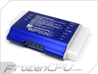

To test it while it's under a load you can either hook it up and put it to use or you buy a PS load-tester specifically. The later is recommended to ensure you don't do any unintentional damage to anything important.
Something like this will give you the thumbs up/down I think you're looking for on the PSU:

These are your "RV640" cards, which you have named wrongly. It should be RV630, which is code of GPU used in ATI 2600XT.
2600XTs are almost that same infamous as 8000GTs. If your MP does start without them, one or both is very likely the culprit.
If you'll read DIAG LEDs description carefully (in Service Manual), you'll notice that ERR A and ERR B could indicate bad PCIe card, not only CPU error. If any is installed in the slot ofc.
