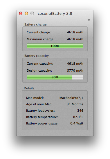

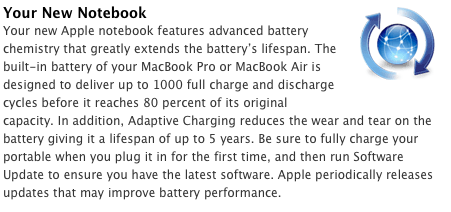

So I was talking to a friend of mine about whether to keep our MBs plugged in or not. On Apple's site it says the battery's designed to deliver 1000 charge cycles before reaching 80%.
I'm at 80% right now with only 346 charge cycles. Is this covered under AppleCare?
I'm covered until August but I'd like to make sure if it's covered it gets taken care of. Anyone have experience with this?

The battery needs to drop below 80% for Apple to entertain a replacement.

take it in if it bothers you, let them know show them that in writing and flat out ask for a replacement, the worst that happens is they say no.
The capacity fluctuates/varies every time you charge. The battery looks normal/healthy to me!
Applecare would only cover the battery if it has any manufacturing defect [ like swells up, health goes down at an unusual rate, .. etc ].
Otherwise, battery replacement is an out of pocket expense!

Batteries are not covered for normal depletion, only manufacturing defects. For details, read the link below. It's not a good idea to keep your MBP plugged in all the time, as that can shorten battery life. Run on battery whenever you need to and plug it in whenever you can. You can plug or unplug any time you need to, regardless of the charged percentage, and you never need to completely drain your battery. Just make sure you don't run on AC power exclusively, as your battery needs to be used regularly to stay healthy. The link below should answer most, if not all, of your battery/charging questions. If you haven't already done so, I highly recommend you take the time to read it.

Li-Po battery technologies work a little bit differently than previous battery technologies (Well, current battery technologies in the PC world, they still haven't quite decided to move into the 21st century with batteries).
LiPo batteries will have a gradual, yet fairly quick drop off down to around 80-85% capacity. Then they will hold this capacity for a great amount of time (this is what makes them so good, they hold most of their capacity for a really long time). THEN, they will start to drop off very rapidly towards the end of their life and fail completely. This 'stair step' way of losing capacity is sometimes confusing when you are used to the gradual loss of capacity over time like with a Li-Ion battery, but it is normal.
For the record, even though a LiPo will drop off very rapidly at the end of it's life, that point at which it begins to drop below 80% is generally hundreds of cycles after a Li-Ion battery has failed completely. Some people have said that LiPo's either work, or they don't. There is no middle ground, and that's mostly true!
If it were me, I wouldn't worry about it. That SMC utility is not the tell-all end-all, it can be inaccurate. It's likely going to hover around 80% for a long time. The real tell is how long your battery actually lasts in your daily use. I suspect it's still close to where it was when new, and I suspect it will remain close to where it's at now for another several hundred or even 1,000 cycles.

The reset certainly won't hurt anything, but LiPo batteries don't need to be calibrated like older battery technologies (Apple even says so on their website in regards to battery calibration on newer, LiPo equipped MBP's)

Shortly after new, a LiPo cell will lose a chunk of capacity. But after that it'll hold for a long long time. That's where you're at, I wouldn't worry about it, IMHO.

Again, these batteries are NOT the same as the old batteries that were used a few years ago. Instead of gradually falling, where 80% of capacity might be considered an end-of-life battery, these batteries will drop rapidly and then STOP. Falling to 80% within the first few hundred cycles and then HOLDING at around 80% is expected behavior from these types of batteries (wheras before, hitting 80% meant you were just around the corner from total failure).
It can seem 'odd' if you aren't used to it, but in the end, you're getting a longer-lasting battery, you just have to deal with the 'quirks' like the way they lose capacity over time, in 'chunks' unlike a gradual fade like Li-Ion batteries. This also means that you'll STILL be at 80% 1,000 cycles from now. It ALSO means that when it dies, it's gonna die all at once, not gradually. You might get 6 hours one day, and a week later be lucky to have 20 minutes. But, that'll be after over 1,000 cycles and long after a Li-Ion battery would have already failed.
He might be able to get Apple to replace it just to keep the customer happy, but in another 300 cycles he'll be right back at 80%(ish), but if he'd hang on to it he'd realize it won't drop below that for a looong time.
