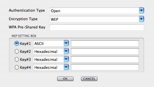

I now have the card installed. It works, but I have an issue with a WEP password. Im using my iMac G5 with internet sharing via airport for the wireless network. It is set up with a WEP 40-bit password. When you click connect it comes up with the attached screen. The two options are HEX and ACSII. Im not sure what to put here. I have typed in a 5-character password in internet sharing, and the same in ACSII on the laptop but it doesnt connect.

For the password, you should probably enter ASCII, unless you know the HEX equivalent. I'm trying to connect to an 802.11n network with WPA security and get a similar problem. The Ralink utility sees the network, but won't seem to connect. I can connect to the same network with the built-in Airport wireless, but only at 802.11g speeds.

I did indeed. I had to change 'open' to 'shared' then put in HEX equivalent password. Although after that, I got more problems concerning self assigned ip addresses, I sorted that out, but its not 100% flawless.
Im not sure if the same solution would work for you, as I believe WPA is another setting under 'shared'. I basically just tried every setting until it worked if that helps.
