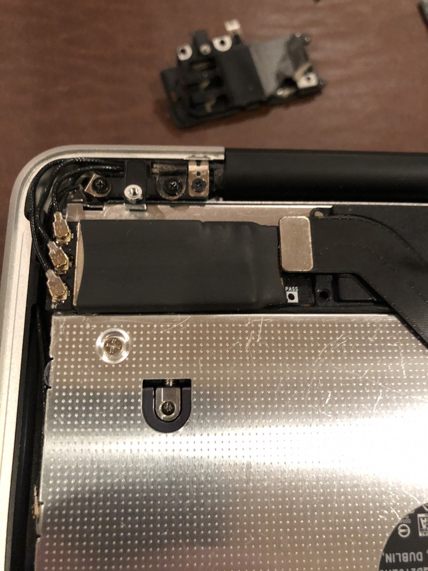

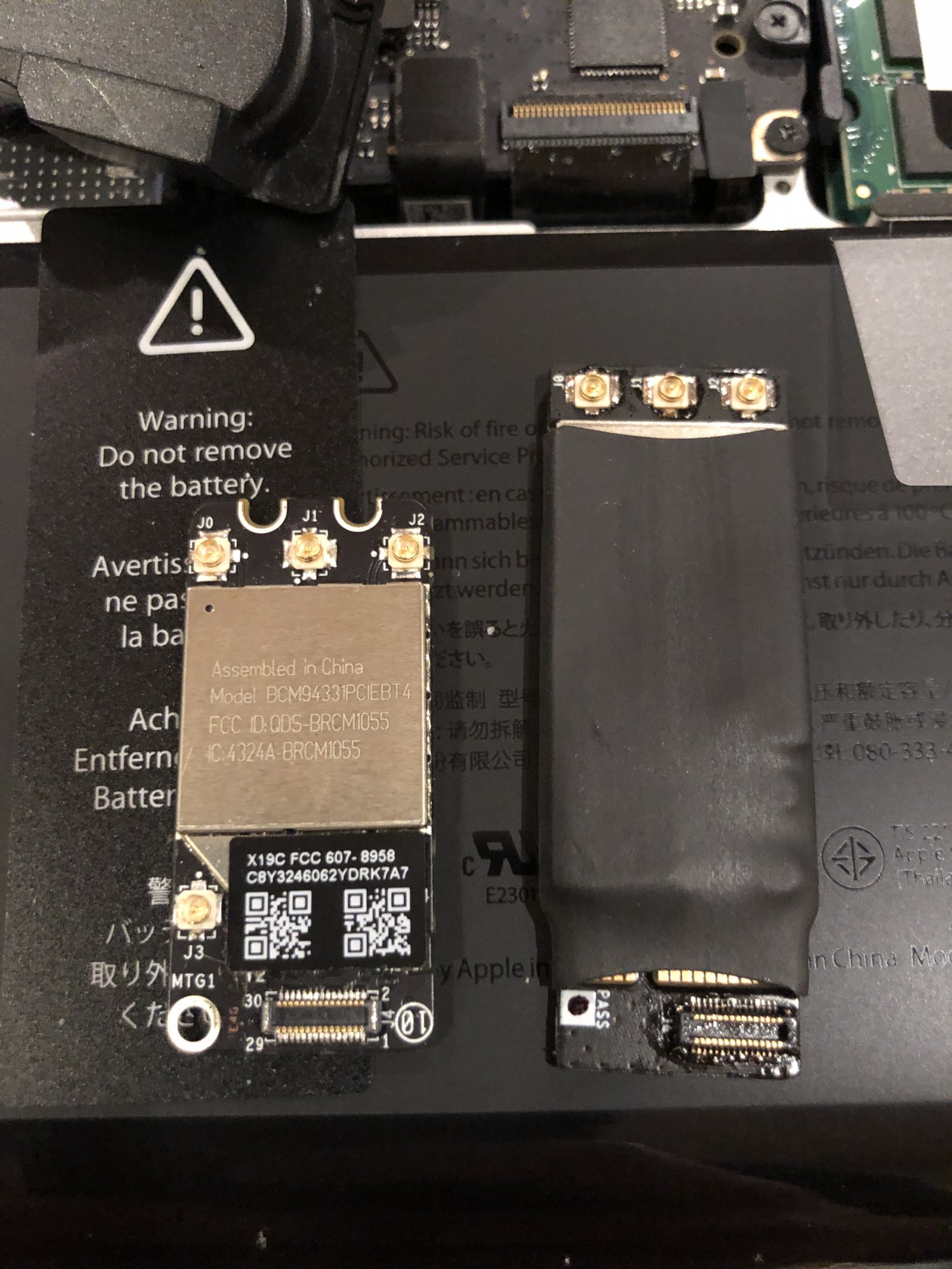

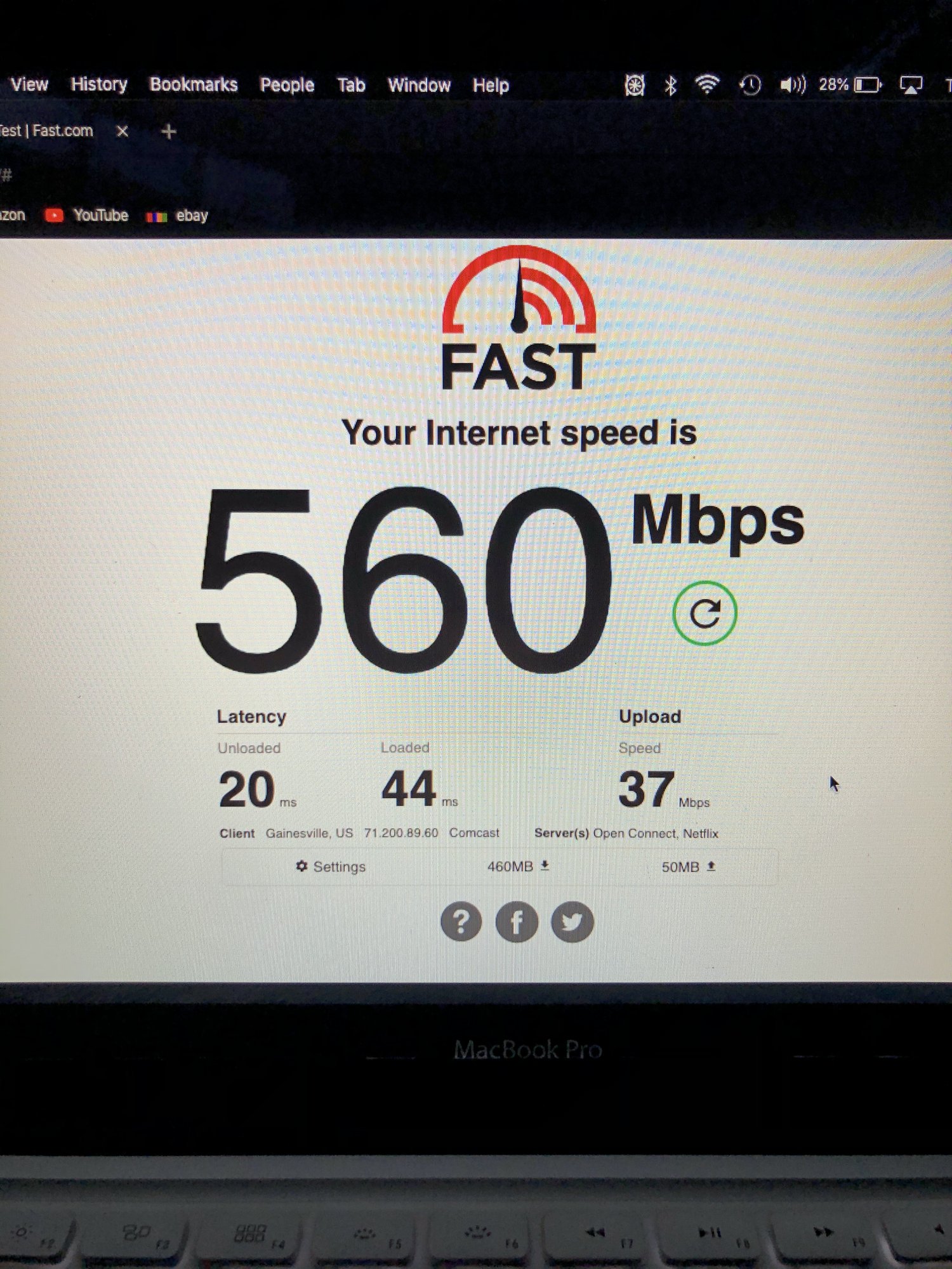

Installed! 13” mid 2012. Getting a consistent 300-500+ Mps using various speed tests, with a 500 - 750 Mps Transmit rate. Best test I’ve gotten so far is attached, 560. Installation was a breeze, the only thing is I haven’t added any tape to the underside of the card to hold it in place, but other than that, upgrade was successful!... I’ll continue to test with different Wifi networks

Hey quick question to anyone thats already done the upgrade, did you even bother using tape to secure the card?
And as a side note (just out of pure curiosity), is the broadcom board I'm replacing compatible with any other mac model? The mac mini from that era seems to have the same proprietary board connection. Don't want to stray too far off topic, but if anyone knows if this is true I'd greatly appreciate any info.
I think that card was in Imac. Don´t know the model.
Yeah, I'm trying to do some research on it. Would be great to reuse the old card I removed since it is still bt 4.0 enabled
The mac mini Airport card has the same 30 pin connector, but if iirc and @highvoltage12v , the pinout is mirrored or reversed so it won't work.
You can put a piece of packing tape going from the top of the optical drive to the top of the upgrade WiFi card.
It´s complex….

Thanks! Thats what I was thinking of doing anyway, but honestly the card sits well as is... I'll add some tape when I have the time 👍
And of course... damn, I figure apple would do something like that. Just looking for ways to repurpose the card. Thanks again!
