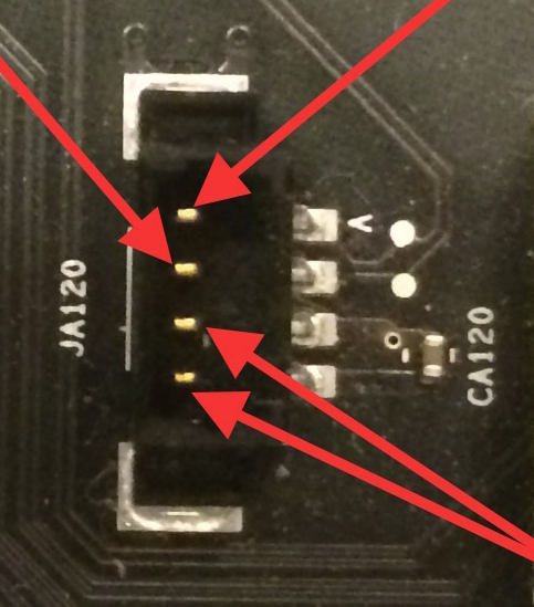

"Originally Posted by X-X View Post
I don't think the original post is correct regarding the pins of the USB cable.
Standard USB configuration is...
1. RED = 5 volts + (often marked with a little arrow)
2. WHITE = Data +
3. GREEN = Data -
4. BLACK = Ground -
If you look at the motherboard of the Mac Pro, the first pin has a little arrow, which means that
this should be "5 Volts +".
Which means the correct pins should actually be the middle ones (second + and third -) unless Apple is intentionally doing this wrong. Why would they do that?
Also you can clearly see the third and fourth pin marked as minus on the motherboard."
I went ahead and included the photo you had attached. (Before you edited it away)
Again I suggest that you just say "whoops, I was wrong" instead of trying to erase your prior words. (and images)

Only one person has come on here giving advice that would likely lead to a burnt out logic board, ace.

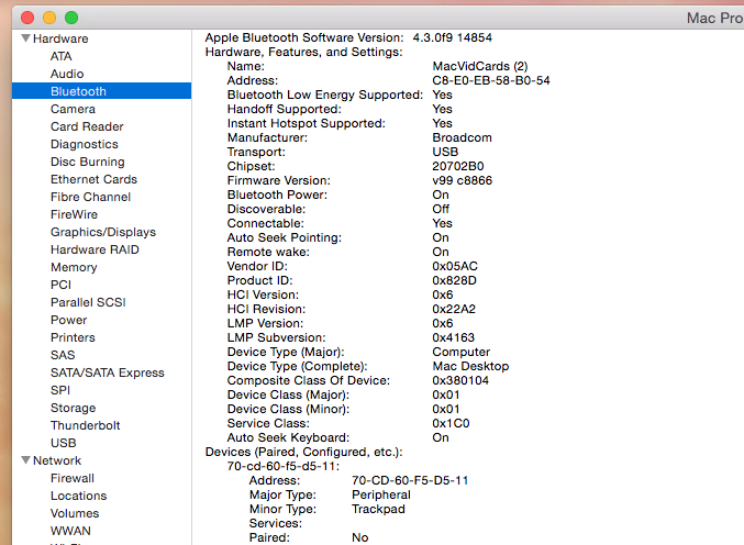

Would have loved to have the antenna available when I ordered! The card itself works great when I pull the USB 3 card. Thanks!

Hey, just wanted to point out that the same card, without the USB fiddling, works perfectly in 1,1/2,1. Gives them full support for Handoff/Continuty and AC WiFi.
Pretty amazing.
(when used with the newly released modded boot.fi)
