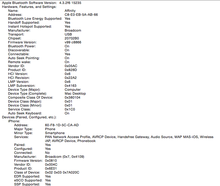

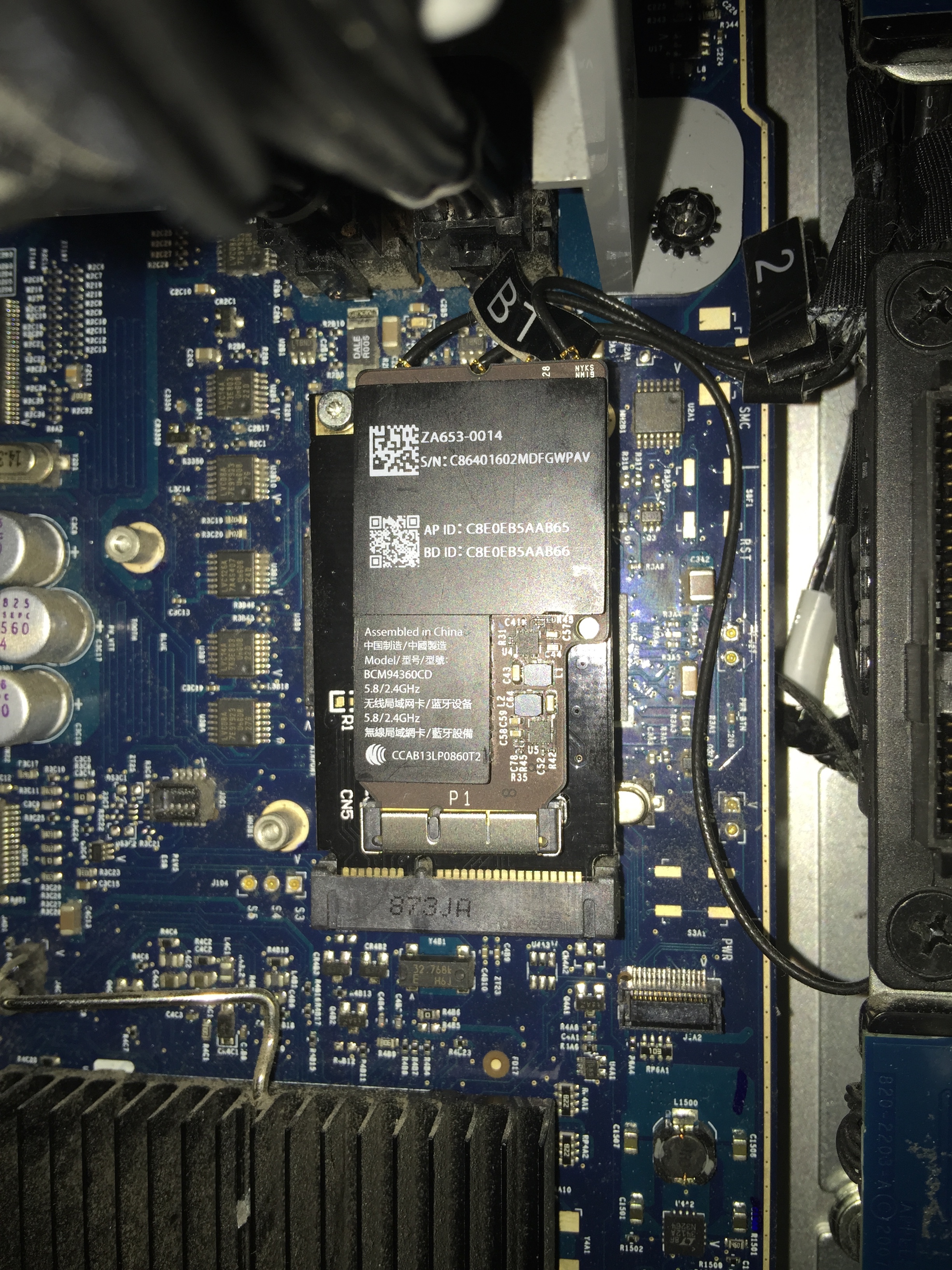

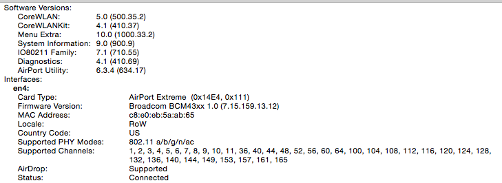

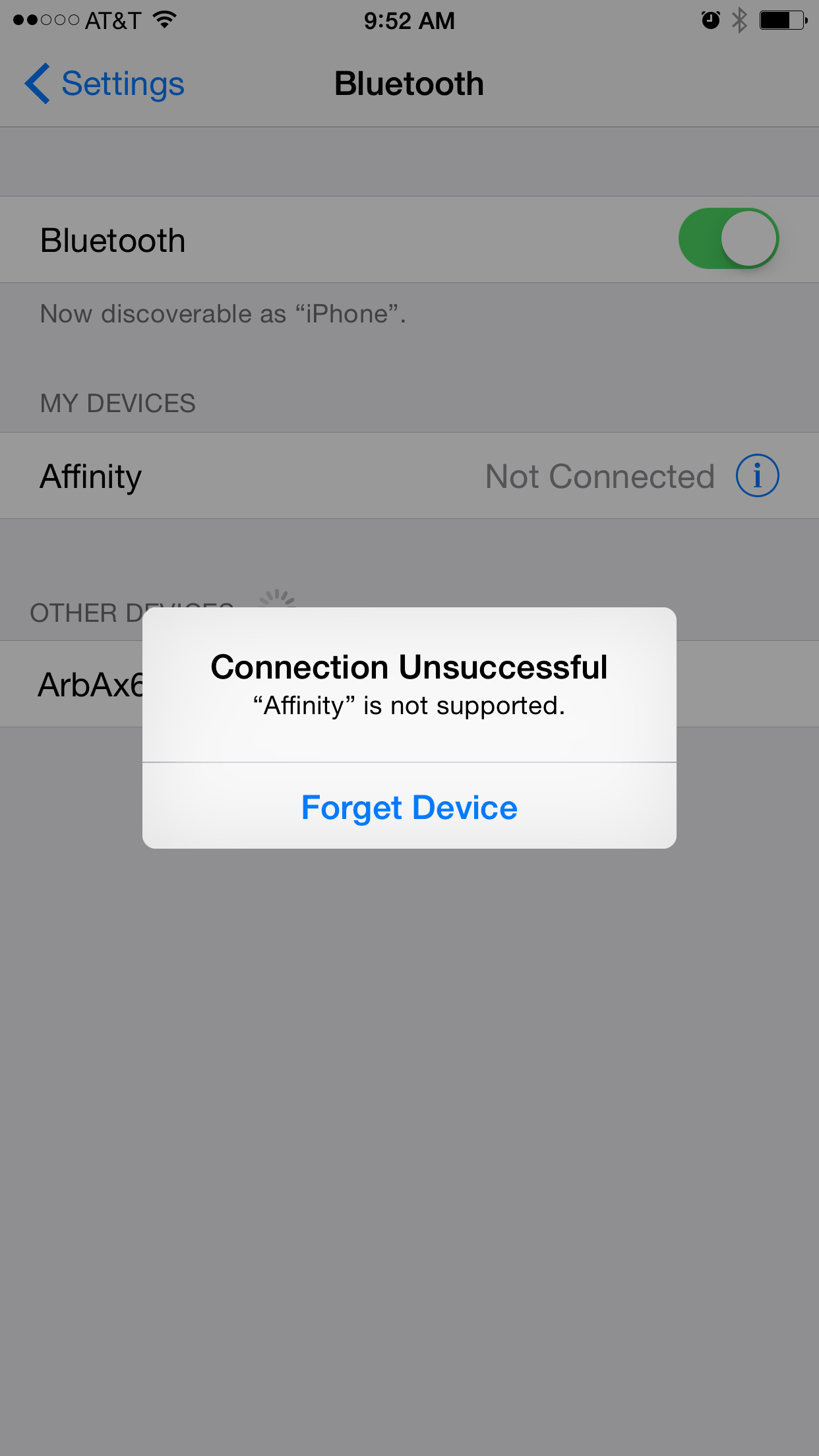

I got a BCM94360CD and adapter installed in my 3,1 Mac Pro, but when I try to connect my iPhone 6 plus via BT, it will pair up, but then just tells me my computer is not supported.
I've tested a BT Mouse and it works fine. and the Wi-Fi has no problem connecting to my network, so I'm sure the hardware is working.
Computer is running Yosemite 10.10.2 and the iPhone is iOS 8.1.3

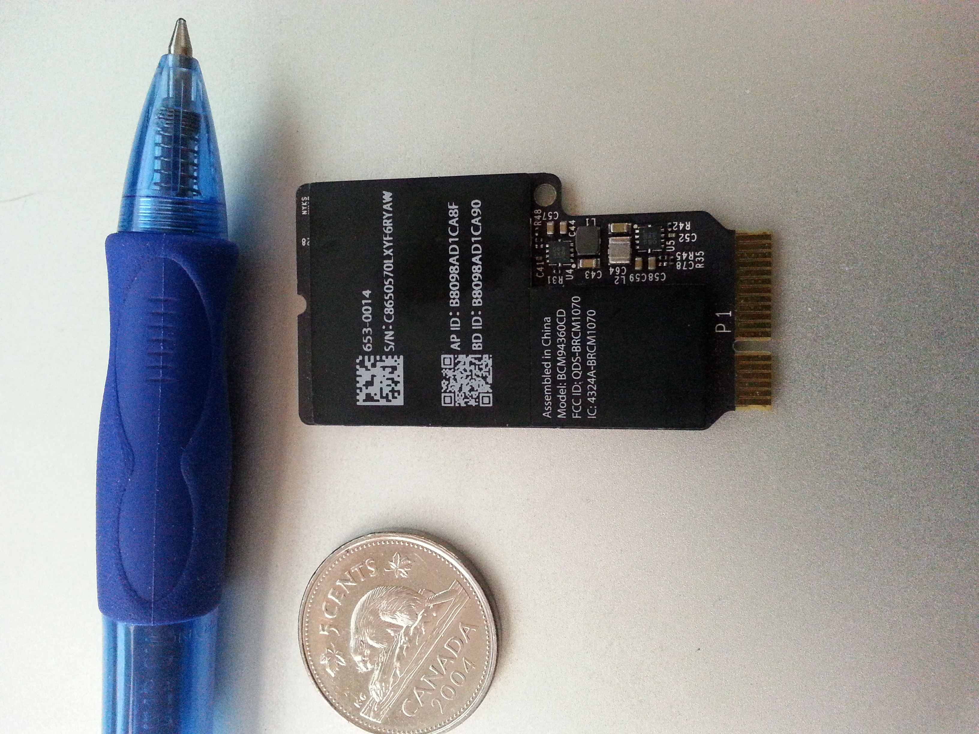

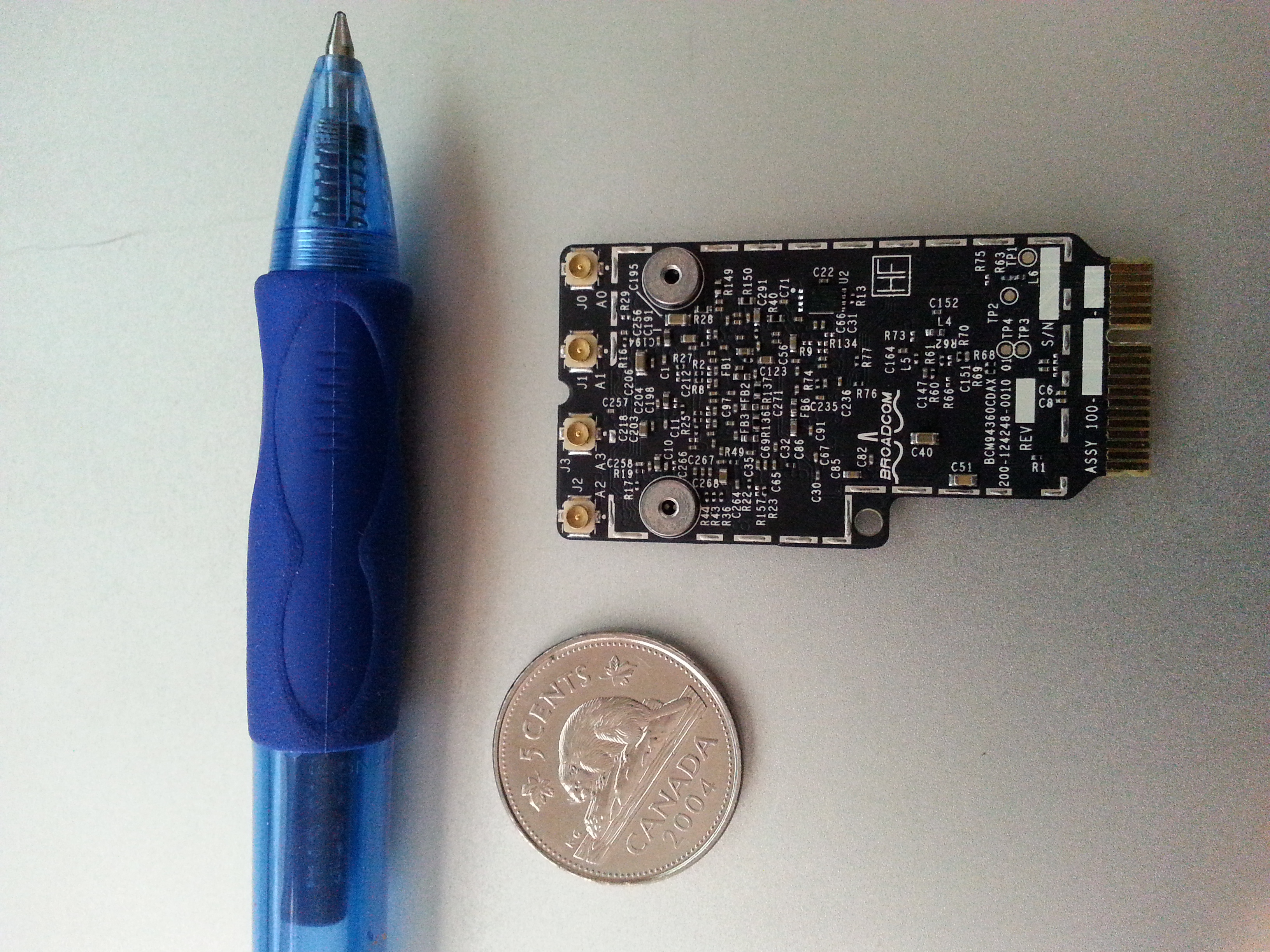

Here are pictures of the card. The model written on the card is BCM94360CD.
As you can see the card is tiny. The 4 antenna connectors on the card are really tiny, smaller then the antenna connectors in the 2006 mac pro.
I was looking at the magnified circuit board and noticed that below the broadcom logo there is BCM94360CDAX
So the model printed on the front is different then the model printed on the circuit board 😛 😛

Not sure what you are complaining about. Those are the standard sized antenna posts that fit the Mac Pro antenna leads.
They should fit just fine.
The card needs to be placed into the proprietary Apple connector to mini PCIe adapter board and plugged in. The 4 antennas should connect to it just fine.
